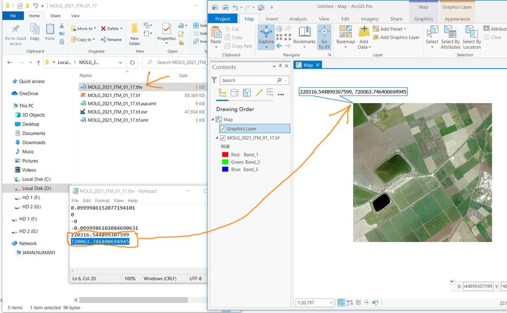

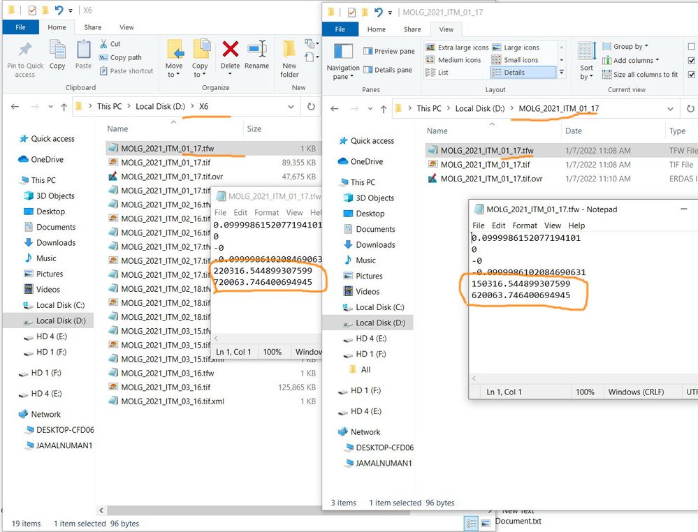

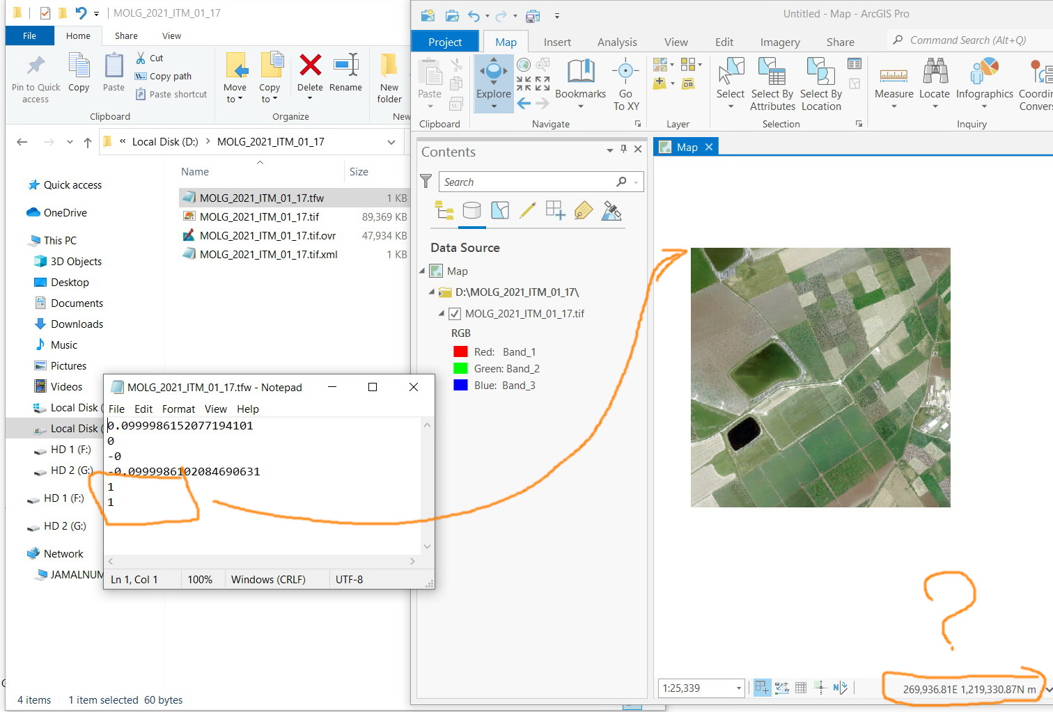

  • I got a tif imagery with no world file.
  • The “Export Raster World File” is performed to create its tfw
  • The xy values available in tfw file are replaced with x=1, y=1
  • The imagery doesn’t move to the new place x=1, y=1
What could be the issue here? Why it fails to move according to its tfw
The imagery can be found here:
https://www.mediafire.com/file/nh4k09n3w46msxp/MOLG_2021_ITM_01_17.zip/file

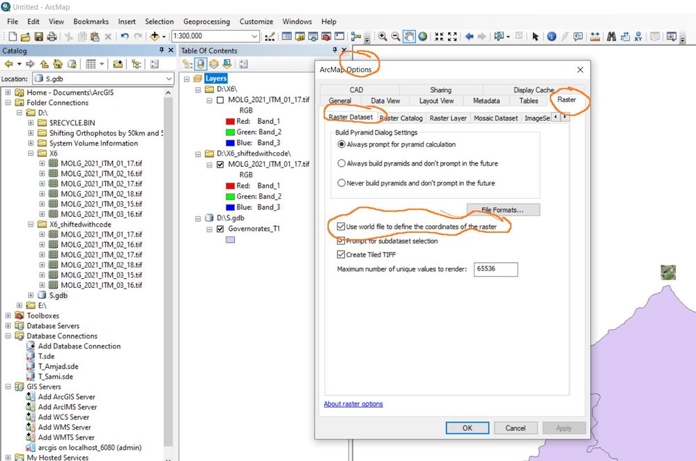

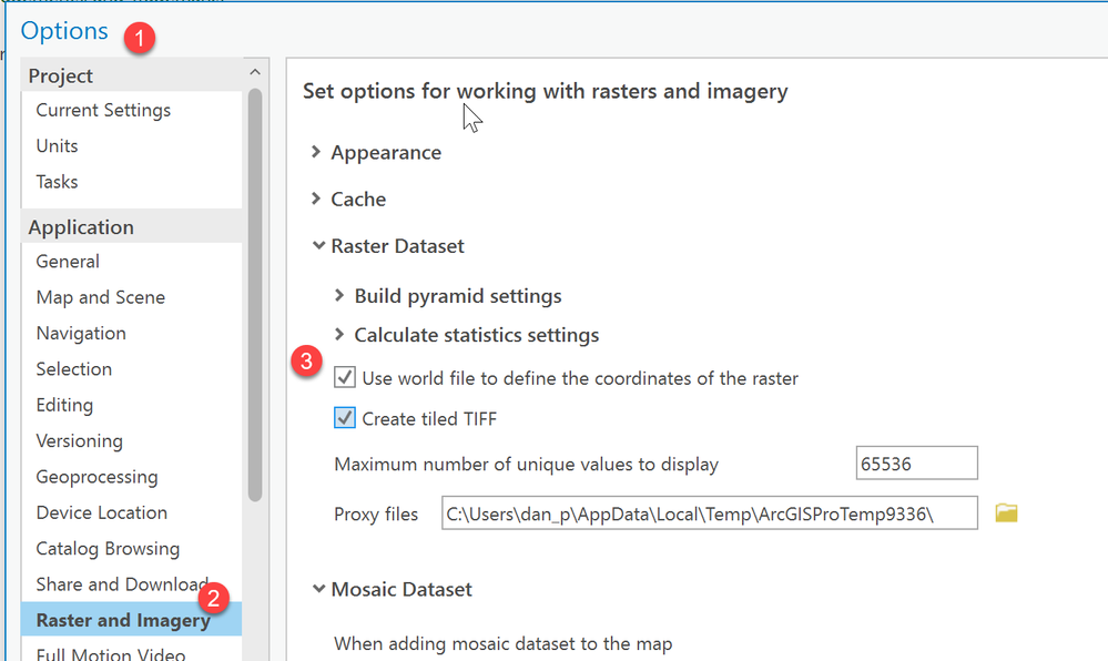

maybe you didn't set Pro to use world files?

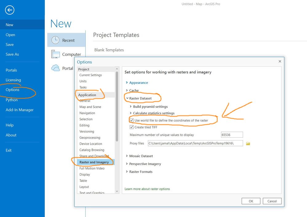

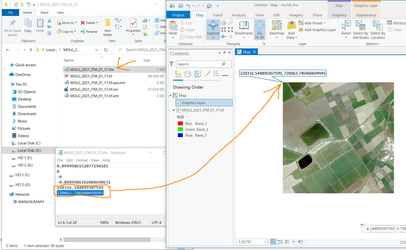

JamalNUMAN
Legendary Contributor
Thank you very much for the help. It works like a charm
