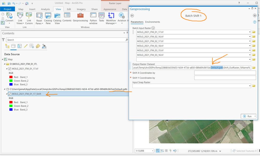

Currently, the output of of the batch shift is compulsory stored in file geodatabase. How to get the output of the batch shift stored in a folder?

This seems too obvious, but have you tried clicking on the folder button next to the current storage path and try redirecting it to a folder location of your choice?

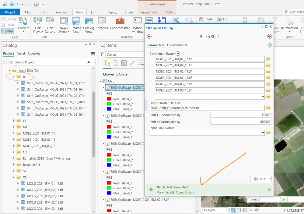

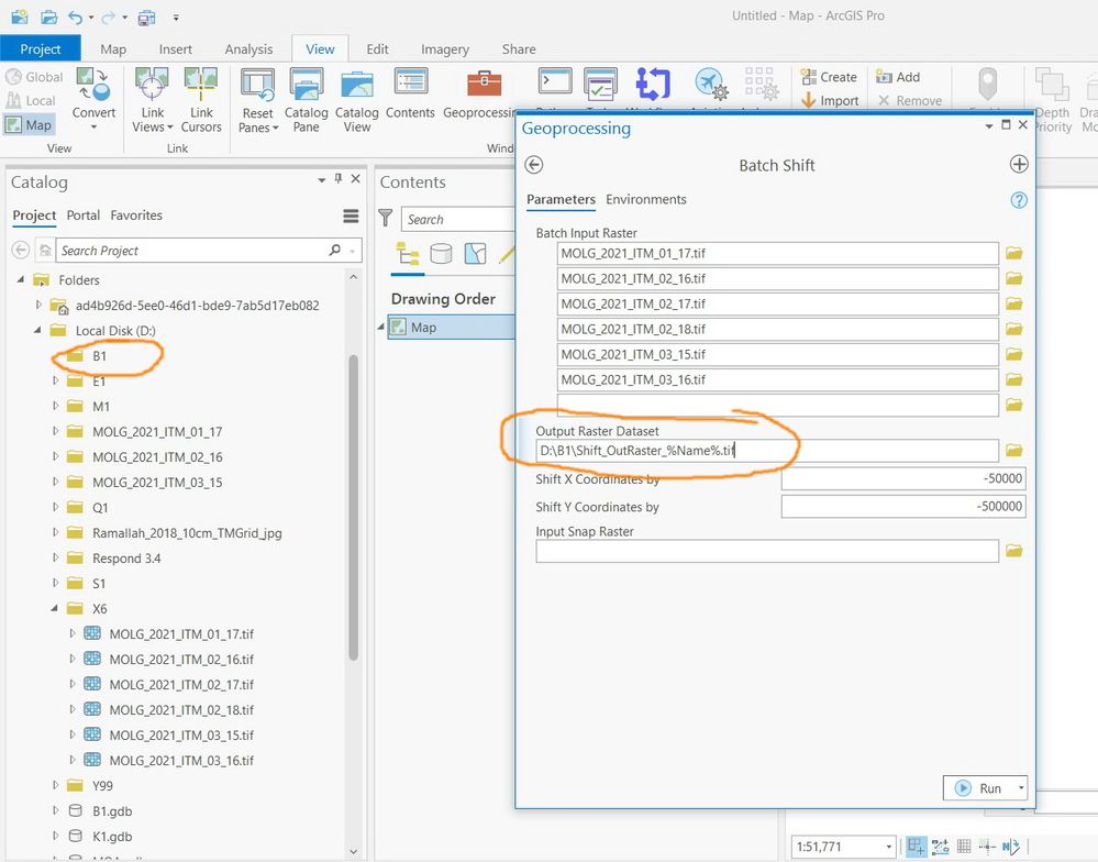

Right the path can be directed to the target folder as below:
D:\B1\Shift_OutRaster_%Name%.tif
