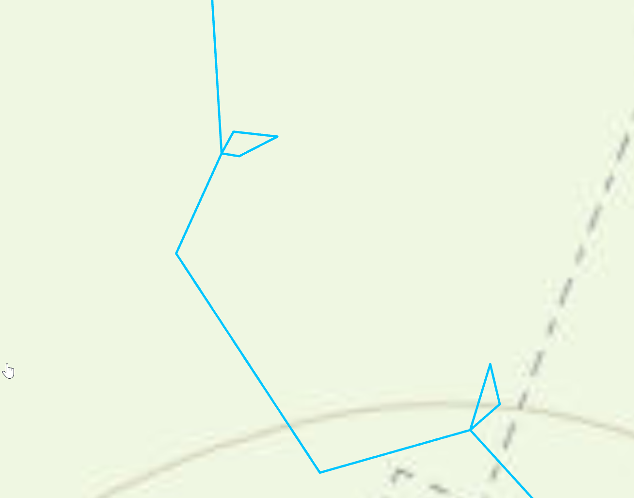

VincentLaunstorfer
Hi all,
Thanks for your help.
1. Unfortunately, the Repair Geometry did not help because dangles are probably too large and not actually geometry problem
2. The Planarize is a good start but it only works for simple self-intersection and/or dangle. Anything more complex need a manual fix, as shown below.
3. The Topology rule... I tried to adjust the XY Cluster Tolerance to 0.001 degree to match my self-intersection but I received an unknown error...
This is all I managed to test this week... As the Repair Self Intersection tool in the Topographic Production extension needs extra licensing, I wonder if there would be a similar tool in QGIS (but I am not as experienced in QGIS!)

JoeBorgione
MVP Emeritus
@TimWitt2 wrote a nifty python add-in a few years back that took care of dangles. It was written for ArcMap but the code might (should?) be able to be adapted to Pro. Your illustration shows some pretty ugly tracks; it's going to take some manual editing to fix stuff like that, so get ready to roll your sleeves up and get your hands dirty.
