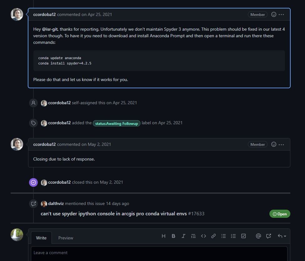

Hi Dan - well that --no-pin option got Spyder installed, after multiple installs/downgrades/upgrades, (looks like mostly to the machine learning packages) - but when I launch it - it chokes on import arcpy, import numpy, kernel is spinning and crashes in windows...
and I found this at Spyder repo...and I found this at Spyder repo...
