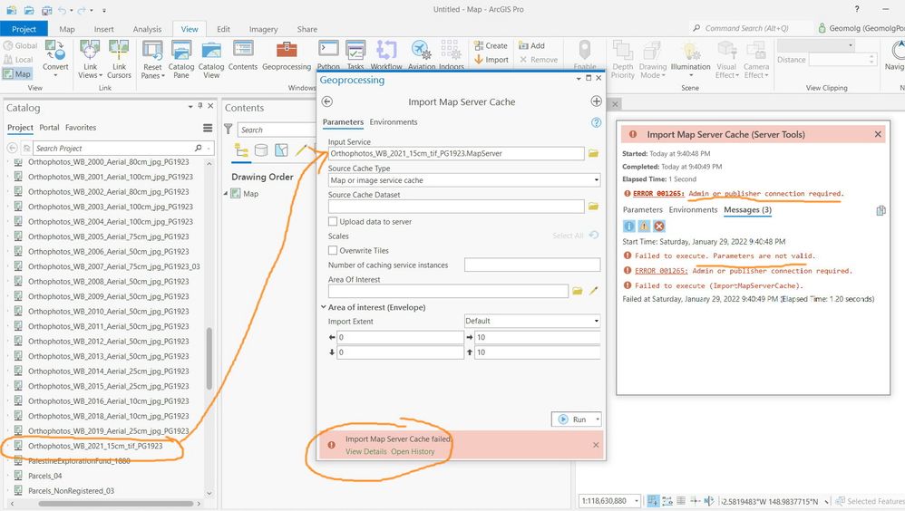

I couldn’t figure out if there is a tool by which imageries can be downloaded from their cached service.

never used it but it matches the keywords
Import Map Server Cache (Server)—ArcGIS Pro | Documentation
... sort of retired...
JamalNUMAN
Legendary Contributor
appears not to work

DanPatterson
MVP Esteemed Contributor
Admin or publisher connection required
and are all the rest of the parameters optional or required? there are a lot of blank lines there

JamalNUMAN
Never worked
