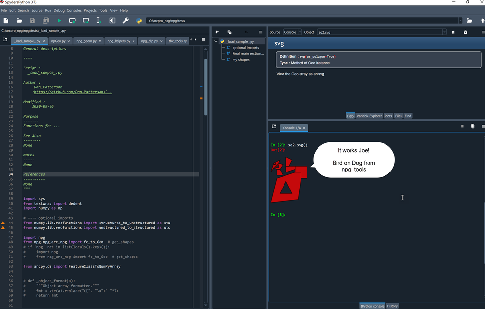

DanPatterson
MVP Esteemed Contributor
Well... couldn't wait
(arcgispro-py3) C:\arc_pro\bin\Python\envs\arcgispro-py3>conda update spyder --dry-run
Collecting package metadata (current_repodata.json): done
Solving environment: done
## Package Plan ##
  environment location: C:\arc_pro\bin\Python\envs\arcgispro-py3
  added / updated specs:
    - spyder
The following packages will be downloaded:
    package                    |            build
    astroid-2.5.8              |   py37haa95532_0         302 KB
    decorator-4.4.2            |     pyhd3eb1b0_0          12 KB
    jupyterlab_pygments-0.1.1  |             py_1           7 KB  esri
    nbclient-0.5.0             |             py_0          59 KB  esri
    nest-asyncio-1.3.2         |             py_0           7 KB  esri
    pip-21.1.2                 |   py37haa95532_0         1.8 MB
    pylint-2.8.3               |   py37haa95532_1         482 KB
    qtconsole-5.1.0            |     pyhd3eb1b0_0          98 KB
    spyder-5.0.3               |   py37haa95532_1         5.5 MB
    spyder-kernels-2.0.3       |   py37haa95532_0         107 KB
    typing-extensions-3.7.4.3  |       hd3eb1b0_0          12 KB
    typing_extensions-3.7.4.3  |     pyh06a4308_0          28 KB
                                           Total:         8.4 MB
The following NEW packages will be INSTALLED:
  async_generator    pkgs/main/win-64::async_generator-1.10-py37h28b3542_0
  jupyterlab_pygmen~ esri/noarch::jupyterlab_pygments-0.1.1-py_1
  nbclient           esri/noarch::nbclient-0.5.0-py_0
  nest-asyncio       esri/noarch::nest-asyncio-1.3.2-py_0
  typing-extensions  pkgs/main/noarch::typing-extensions-3.7.4.3-hd3eb1b0_0
The following packages will be UPDATED:
  astroid                                2.5-py37haa95532_1 --> 2.5.8-py37haa95532_0
  pip                                 21.1.1-py37haa95532_0 --> 21.1.2-py37haa95532_0
  pylint                               2.7.4-py37haa95532_1 --> 2.8.3-py37haa95532_1
  qtconsole                              5.0.3-pyhd3eb1b0_0 --> 5.1.0-pyhd3eb1b0_0
  spyder                               5.0.0-py37haa95532_1 --> 5.0.3-py37haa95532_1
  spyder-kernels                       2.0.1-py37haa95532_0 --> 2.0.3-py37haa95532_0
The following packages will be DOWNGRADED:
  decorator                              5.0.9-pyhd3eb1b0_0 --> 4.4.2-pyhd3eb1b0_0
  typing_extensions                    3.7.4.3-pyha847dfd_0 --> 3.7.4.3-pyh06a4308_0
Of course, I didn't "clone", I installed in base.
