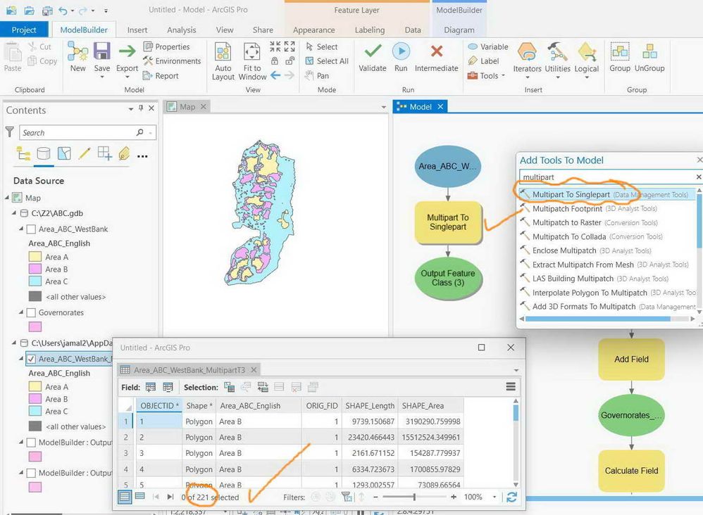

ArcGIS Pro 2.8.4: What is the equivalent tool to “explode” that can be performed in model builder?
It appears that the “explode” tool is not available while working with model builder. Is there any equivalent tool?
Solved! Go to Solution.
Multipart To Singlepart (Data Management)—ArcGIS Pro | Documentation
Thank you for the help. It works fine
