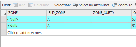

Data when pasted
Is anyone else seeing this problem, this used to work unit I updated to 2.7.

Same workflow, and yours is only keeping the template, of the AA. So it does not keep the field value in the type of field.

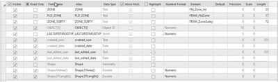

I have 3 fields with Domains on them. When I copy the values are null. Attached is my table schema. I am using Fld_Zone, and Zone_Subty as my symbology layer. When I copy all of the fields that are not Fld_Zone are null.

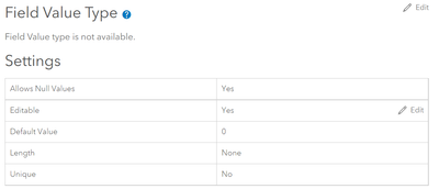

Thanks for the response and info Scott.  I've determined the issue.  I am copying/paste special from/to hosted feature services.  I had changed the editability on the source layer.  If a field is not editable, it will not copy/paste special to the target layer.  This is not ideal.  I don't feel that the ability to edit should have anything to do with copy/pasting attributes.  See below - if Editable is set to "No", it will not copy/paste special.

@LukeGilner1 Thanks for the feedback. I assume you mean you are pasting from one layer to another and the source layer has some fields that are marked as non editable but you want to preserve those attributes in the target layer, which has the same attributes that are marked as editable. Is that correct or is the scenario different in some way?
LukeGilner1
Yes, that is correct.
Scott_Harris
@LukeGilner1 I can reproduce that behavior so thanks for reporting it. This will be fixed in a future release of ArcGIS Pro.
