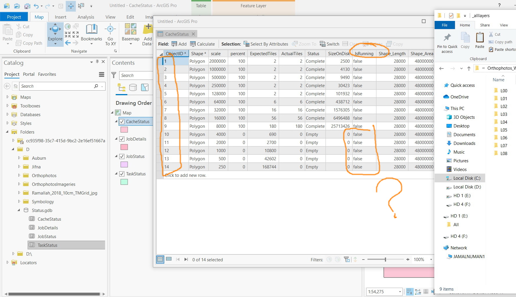

I couldn’t figure out why publishing fails to cache at all scales.

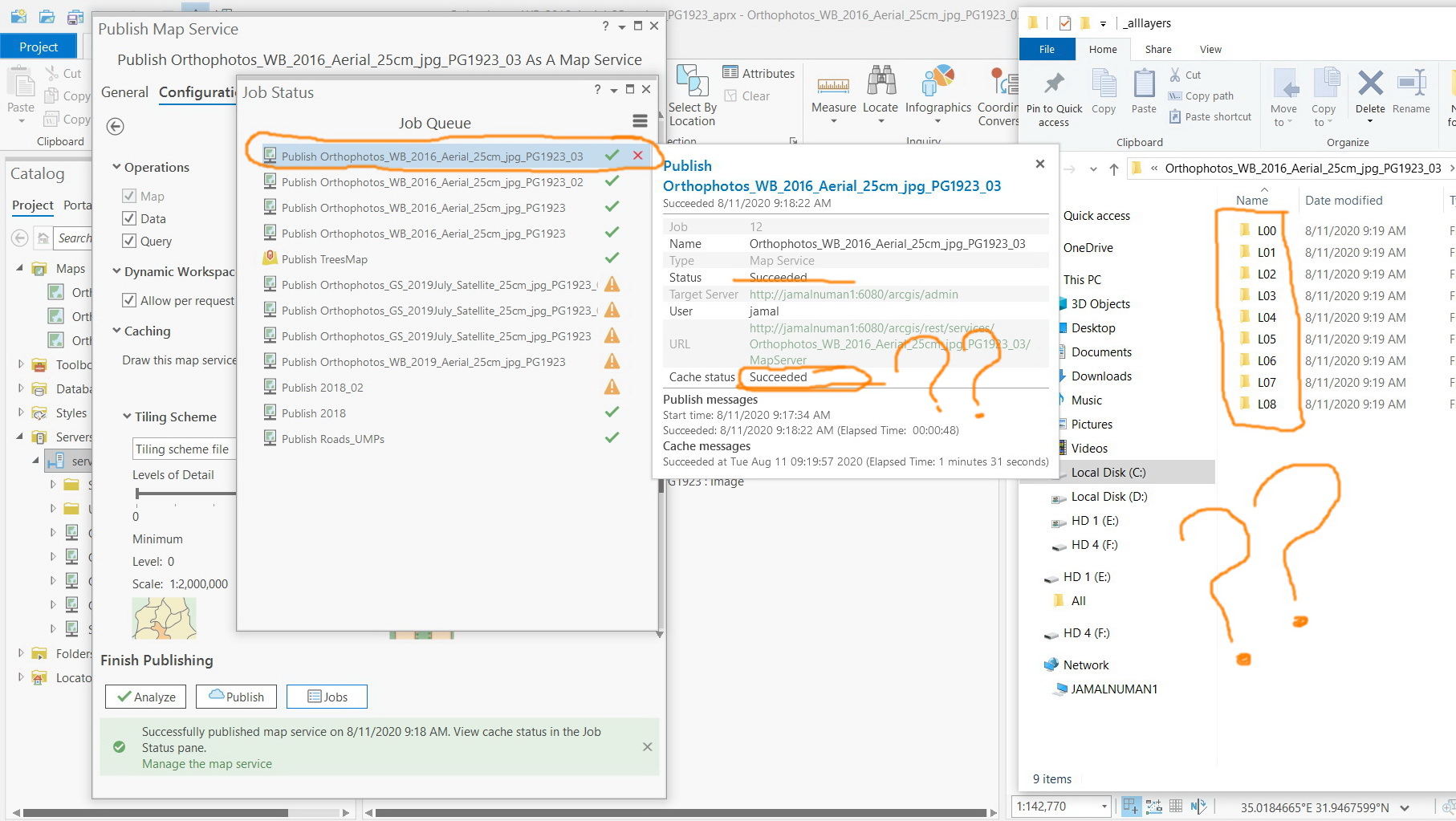

In the screenshots below, I wanted to catch a mosaic at 14 scales (from L00 to L13). I observed that it stops at L08 despite the fact that it says “succeeded”
What could be the issue here?

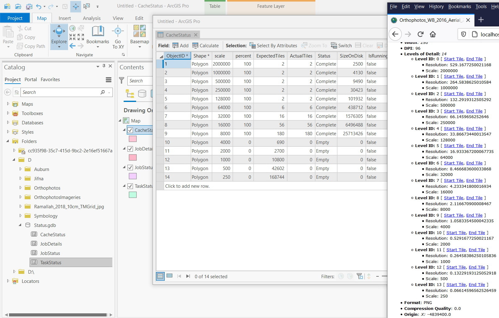

Correct. I tried to re-create the scale tiling scheme and it worked fine. I’m attaching the two files: the one that fails to work and the working one!
What could be the issue here? Both of them are created by the tool and the content is never touched
Is this a bug?

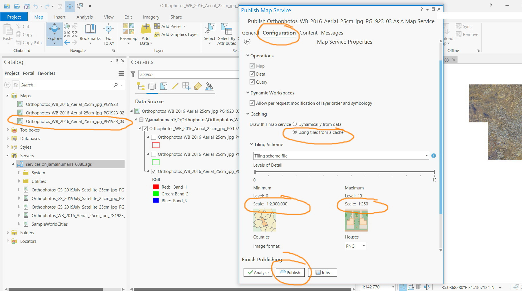

Did you have the cache to be automatically created on the server or manually?
You may want to look at the server CachingTools service. You may need to kick off the process again. I usually publish the service, then start the caching process on the server.
Thanks George.
It is cached automatically is the server.
