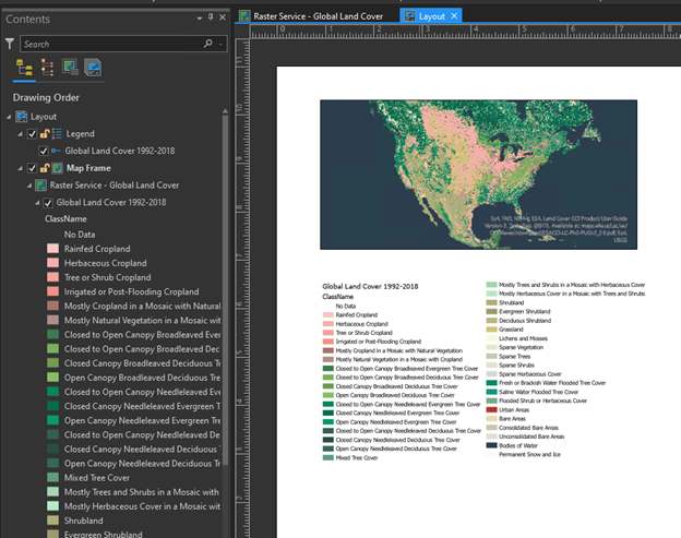

TomBole
Hi Joanna,
The Global Land Cover 1992-2018 service is a different service type than the service types referred to in most of this thread.  Global Land Cover 1992-2018 is a Raster service.
I was unable to get a legend using 2.6 or 2.5. I have confirmed that the legend is showing up in 2.7.
I'm not familiar with the history of legend support for this service type so I do not know if this was supported in the past, though you say you were previously seeing the legend items for this service.  I'm just curious... do recall which version of Pro you were using?
