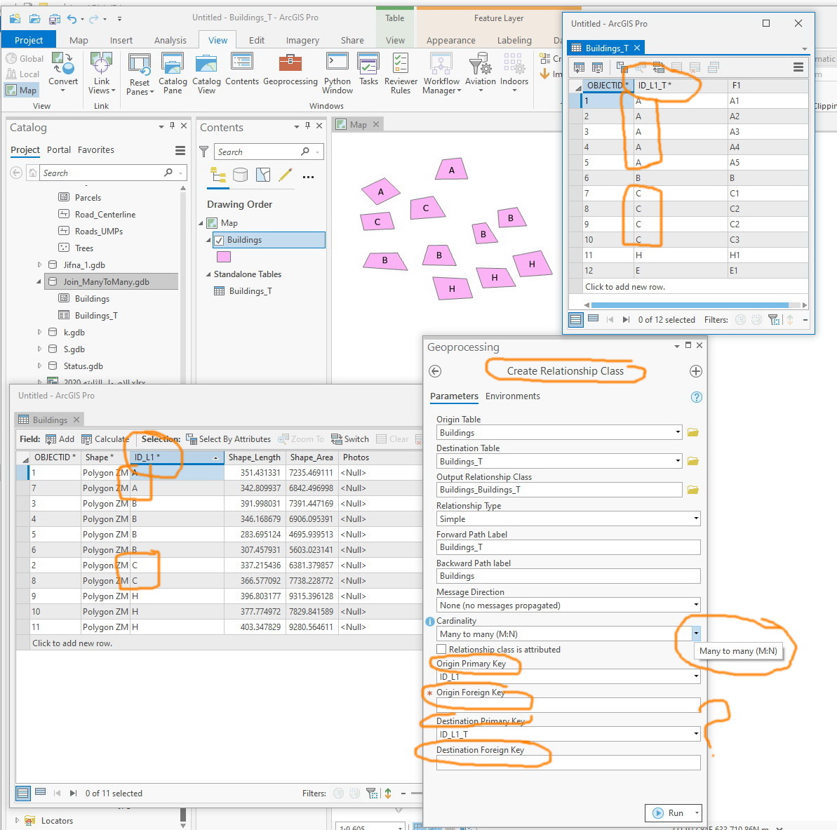

I couldn’t figure out how to perform “relationship class” with many to many (M:N) option
For example, I wanted to relate the attribute of feature class below with a standalone-table via ID_L1 and ID_L1_T fields respectively.
Then what I’m supposed to fill in the origin primary key, origin foreign key, destination primary key, and destination foreign key?

and many-to-many cardinality... you will have to figure out your origin and relationship class tables and select the appropriate fields.  There are only a few combinations that you can try... what did you try?

Here is how I set up a M:N relationship using the Table to Relationship Class geoprocessing tool. This ties together the Management Regions features to the Source table using the Region_Source relationship table.

But how to work with “create relationship class” tool?
Jamal Numan

Most, if not all, of the parameters should be the same as in the Table to Relationship Class tool. Have you read this documentation?

I have read the documentation but unfortunately there is no concrete example in how to perform the tool
