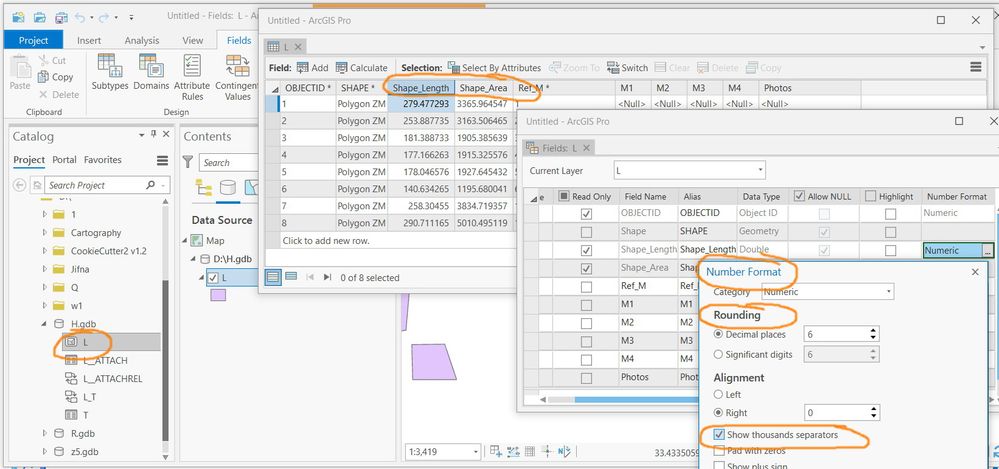

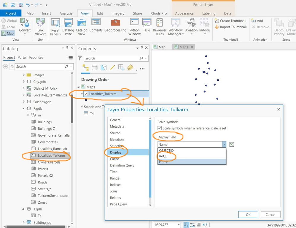

As per the screenshot below, the “display field” can be set for a feature class at the content level. Is this possible to be set at catalog level?

Jamal - I don't believe this is possible.  I did look at ArcMap and ArcCatalog 10.8.x to see if this was an equivalency item.  It does not appear to be so.  There was an enhancement request (NIM040456) back in the ArcGIS 9.3 days - "please add the option/functionality of setting the Primary Display field as a Feature Class field option within ArcCatalog."  It closed as "Not in the Current Product Plan."  I would think this still applies in ArcGIS Pro as well.

It’s unfortunate that this is still not implemented. We are wasting much of time resetting our data each time to add them to the map to match our preferences.
This also extends to include all other properties such as “format number” and “visibility”

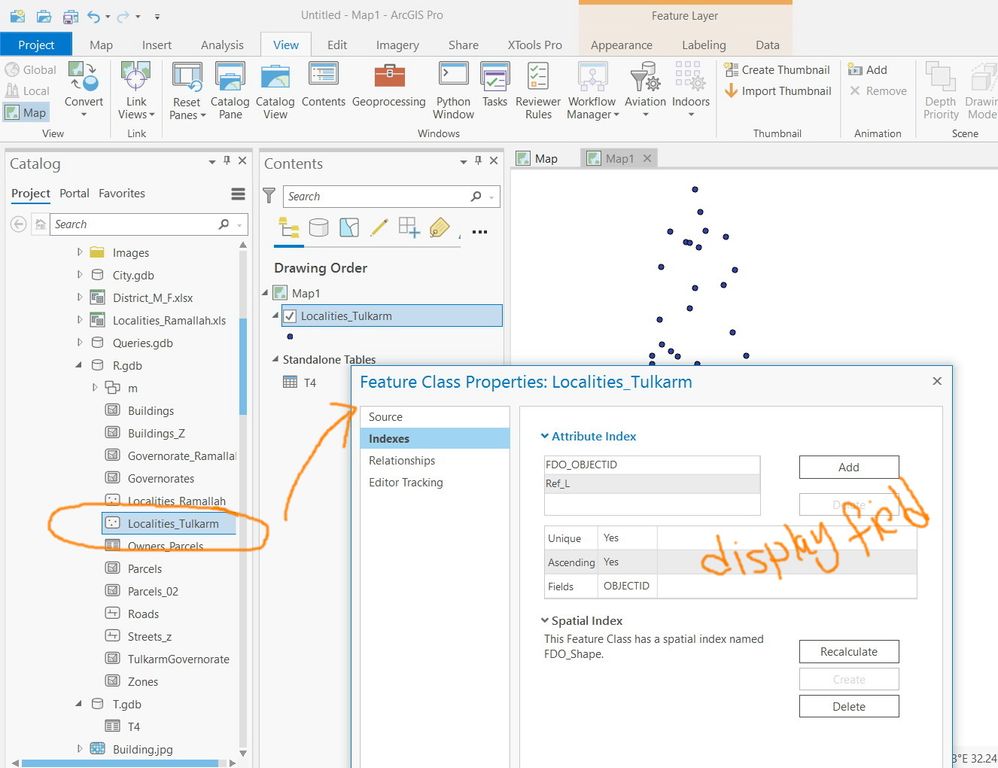

I need to set it for a table (so a relationship will show it in the identify window). This cannot be done in the geodatabase level or in arcpy.
