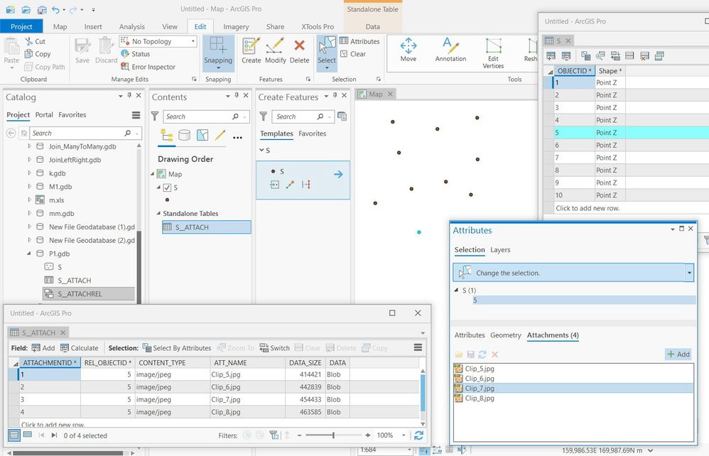

If you try to perform the “enable attachments” option from scratch, you will be finding out that the attachments are saved as per screenshots below
The issue in this thread is to find out how to rebuild the “relationship class” if it’s deleted!

If the attachment relationship is deleted and rebuilt then the photos are not displayed as per the screenshot below
Jamal Numan
Geomolg Geoportal for Spatial Information
Ramallah, West Bank, Palestine
Robert_LeClair
Esri Esteemed Contributor
Yes sir - that's what I saw too!
