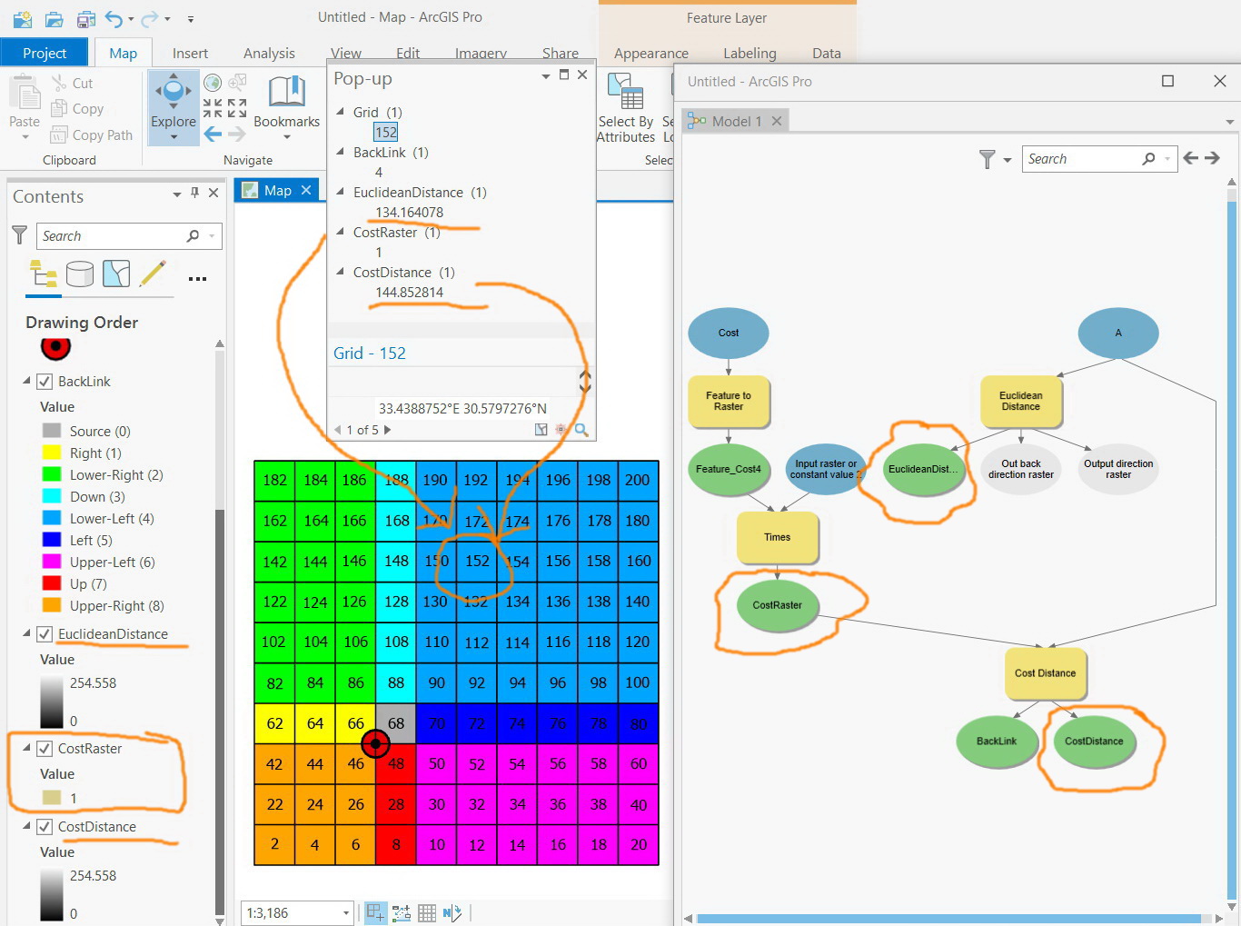

ArcGIS Pro 2.5: What is the mathematical formula based on which the “cost distance” is calculated at any cell?

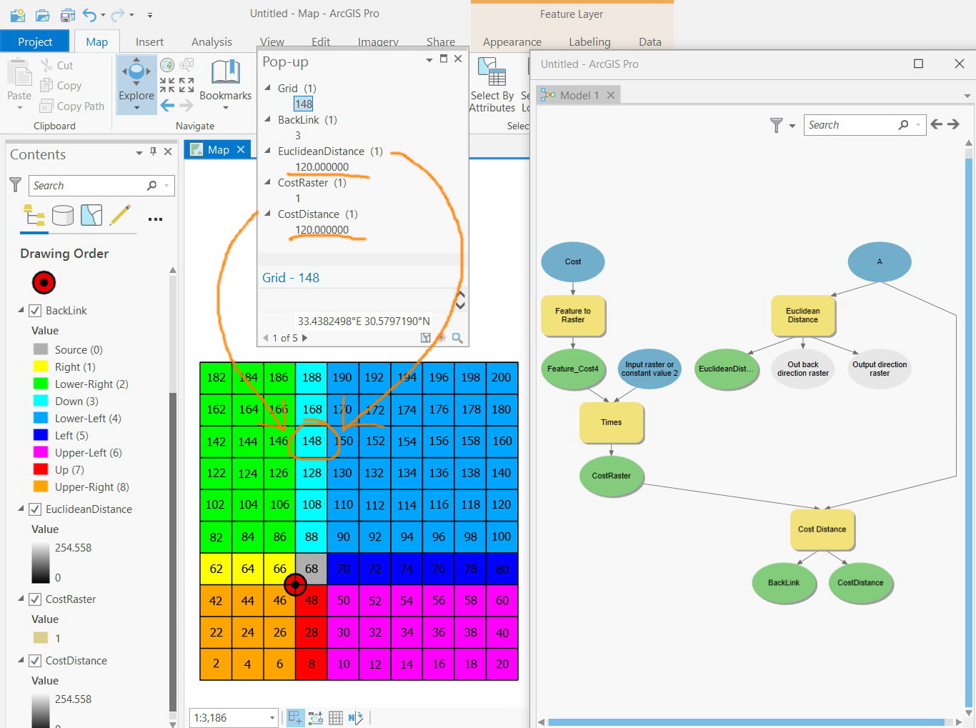

For example, in the screenshot below, the “cost distance” at the cell number “152” is “144.85”. in return, the value of the “cost distance” at the cell number “148” is “120” which equals the value of “Euclidean distance” at that cell.
What is the mathematical formula based on which the “cost distance” of a cell is derived from “cost raster” and “Euclidean distance” of that cell?
For simplicity, all the cells of “cost raster” is made to have the value one. I observed that the equation below is valid to calculate the “cost distance” at some cells (but not all):
Cost Distance = Cost Raster * Euclidean Distance

Jamal:
a cost raster cannot have cells with zeros. The outputs will not be valid.
cost distance computes network distance (sum of edge weights) over a set of network nodes and edges. The input cost raster is used to assign weights to those edges. A zero weight on an edge means you could travel over that edge as many times as you wanted without increasing your cost, so your shortest path through a set of zero valued edges is not defined. One way to think of a zero weight is that it means you could be in multiple locations at the same time.
The backlink raster records the set of directions you must follow when you start from an arbitrary location and want to use the shortest path to get back to the source.
As i explained above, euclidean distance will equal cost distance when you travel in certain directions, as is the case with cell 46 in your example.

Jamal:
What value were you expecting in the upper right corner cell?
Keep in mind that your source ("A") is going to first get moved to a cost cell center. Judging from your result, A is getting moved to the center of its NE neighbor.
As Dan's link explains, the cost distance algorithm computes shortest distance on a network.That will happen to be the same as euclidean distance when the shortest network path and the shortest euclidean path coincide. That coincidence happens when your euclidean destination lies along one of the allowed directions of travel from the source imposed by the cost distance network.
At arcgis pro 2.5, we've introduced a new set of distance tools: DistanceAccumulation, DistanceAllocation, and OptimalPathAsLine, which compute true shortest weighted euclidean distances and paths over a cost surface. If you try those tools, you should see that DistanceAccumulation with a cost surface of '1's produces substantially the same result as EuclideanDistance in all directions moving away from the source (there are some small differences, closer to source cells, which become less as you move away from the sources).
