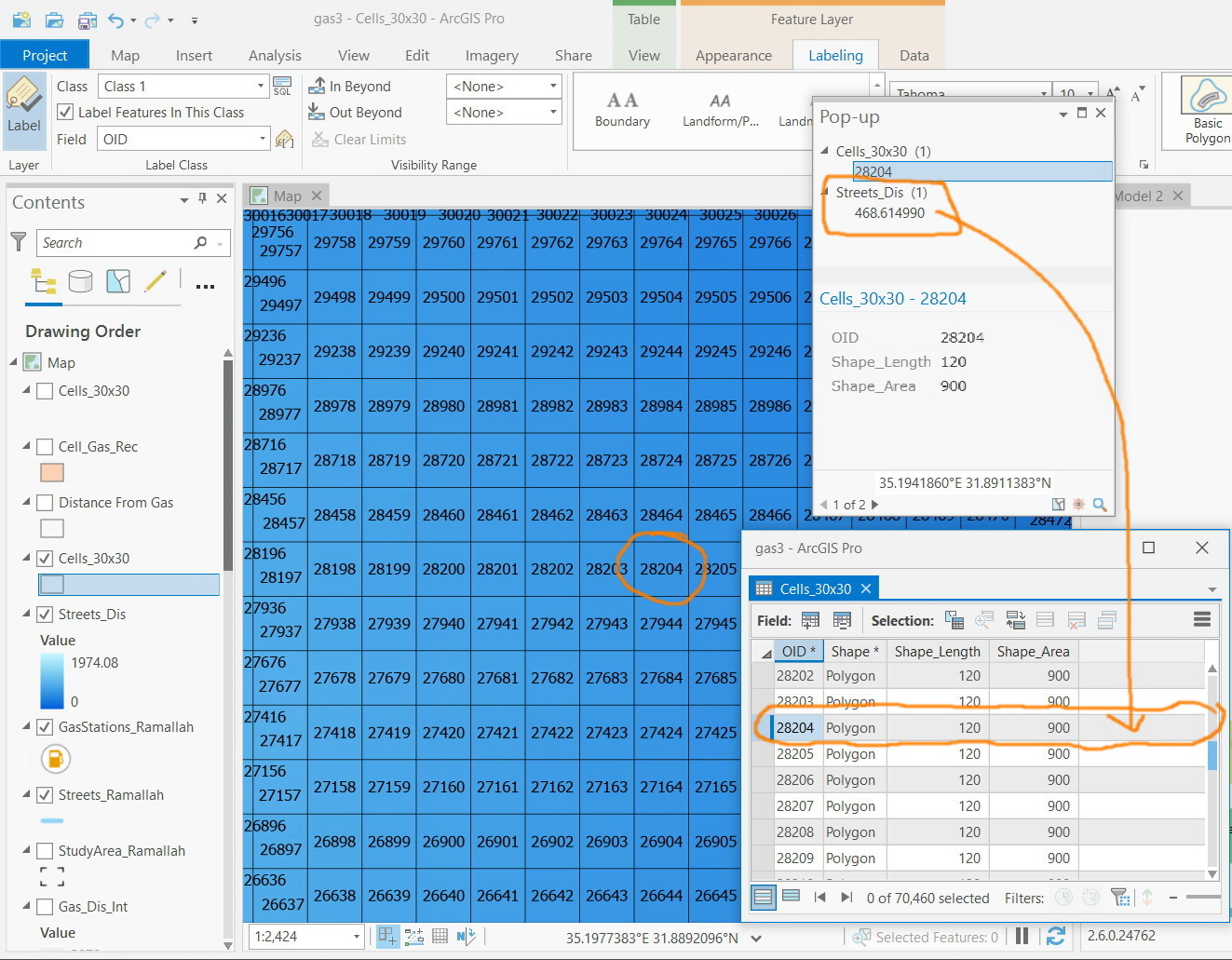

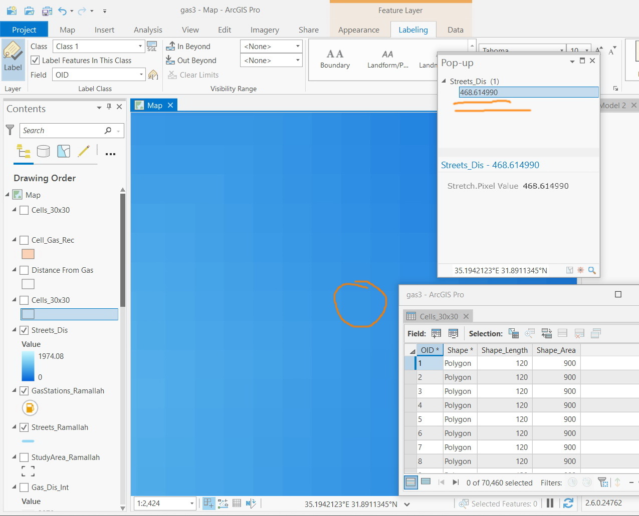

In the screenshot below, I wanted to transfer raster cells values to their corresponding polygons (30x30). For example, the cell#28204 has a value of 468.61. I wanted this value to be transferred to its corresponding polygon.

I would use the Zonal Statistics as Table GP tool Zonal Statistics as Table—Help | Documentation and then join the results back to the input feature layer.

When you run the Zonal Statistics as Table tool, you need to add your polygon file (Cell_30x30) as the "Input raster or feature zone data" layer. Then you need to specify a "zone field", a unique identifier for the areas you want to summarise the raster data for. In your case it will have to be the OID field.
Then add your raster and run the tool. Then open the output table and you should have a summary statistics for each of your OID polygons. Then join back using Add Join or Join Field GP tools, using the OID field.
