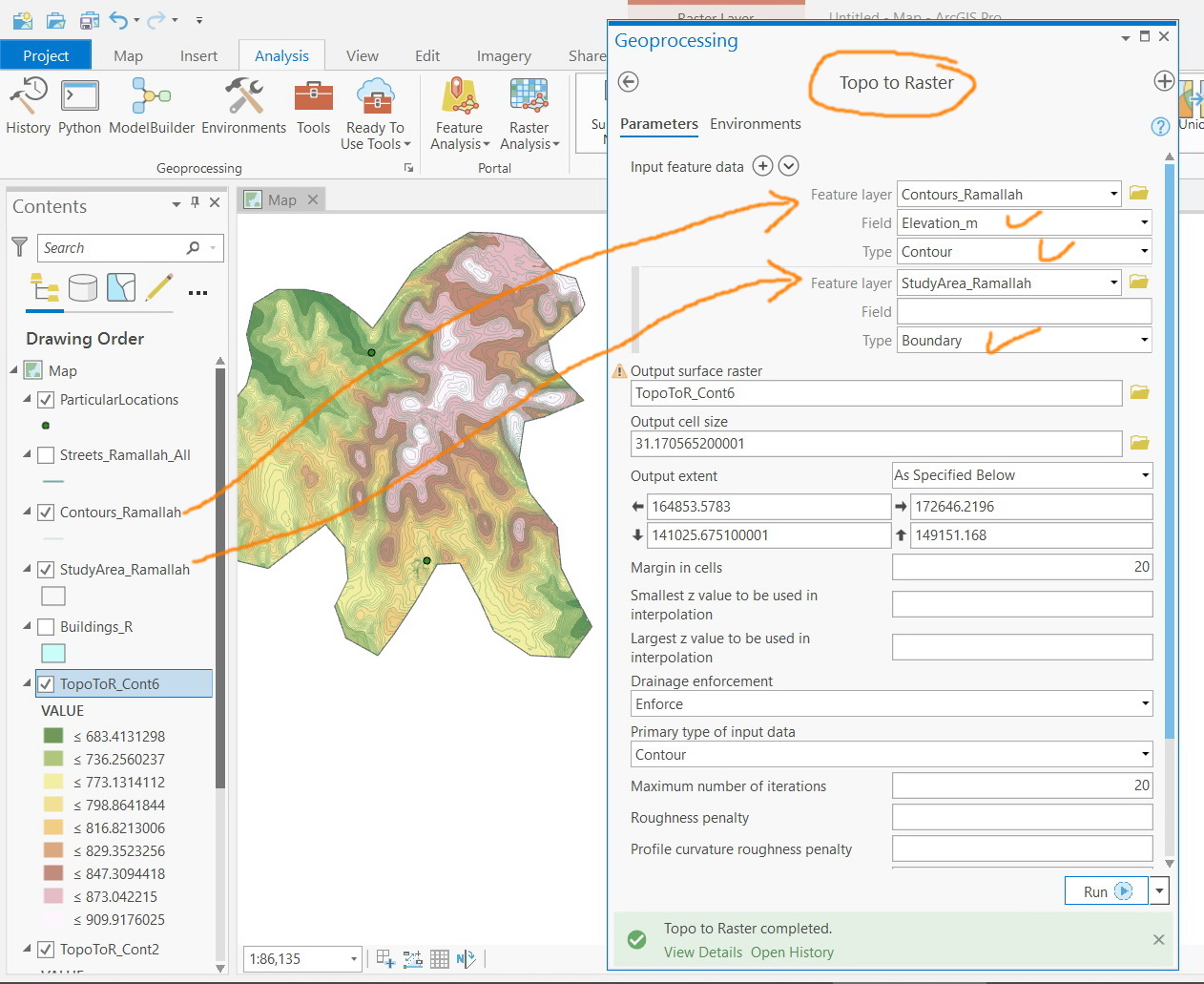

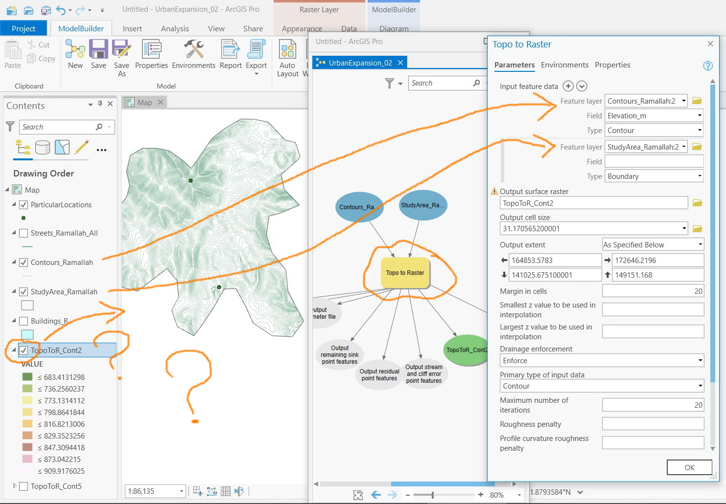

I couldn’t figure out why the “Topo Raster” tool fails to generate output when working in a model builder despite the fact that it works properly as a standalone tool (outside the model) knowing that both are working with same environment settings
What could be the issue here?

It appears that my point is not clear. My issue here is not how to display the output in the table of content
Let me paraphrase the issue as below:
- If the “Topo Raster” tool runs from inside a model, then the output is empty
- If the “Topo Raster” tool in a stand-alone mode, then the output is correct and as expected
- In ArcMap, either way, if the “Topo Raster” tool runs from inside a model or as a stand-alone tool, the output is as expected
Have you already tried to run the “Topo Raster” tool from inside the model? How about the output? Is it empty?

In your model, add CopyRaster with the output from TopoToRaster as input and Add to display its output, does it display?
I can repro your case and will log an issue.

You catch it Steve. Performing the “copy rater” tool has an output!
What could be the issue here? Is this a bug as the “topo to raster” tool used to work fine in ArcMap without the need to perform “copy rater” tool?

No, it'll be fixed in 2.7.
BTW, another work around, if you change your output from fgdb to .tif it works as expected.

It is a bug in that it is not releasing the lock. I've logged an issue and it'll go into the bucket of things to fix. I can't make any promises that it'll be fixed in 2.6 though.
I'm glad that the workaround fixes your problem.
