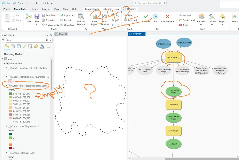

I couldn’t figure out why the “Topo Raster” tool fails to generate output when working in a model builder despite the fact that it works properly as a standalone tool (outside the model) knowing that both are working with same environment settings
What could be the issue here?

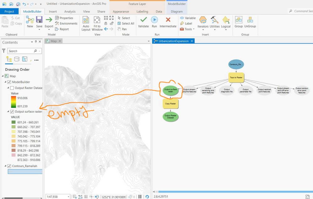

This appears not to be resolved in 2.8.4

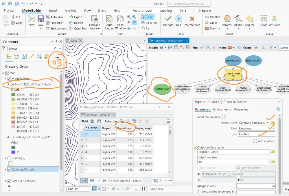

The issue persists to exist even in the Pro 3.1.5

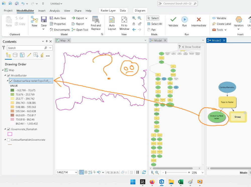

This bug persists even in Pro 3.4.2.
