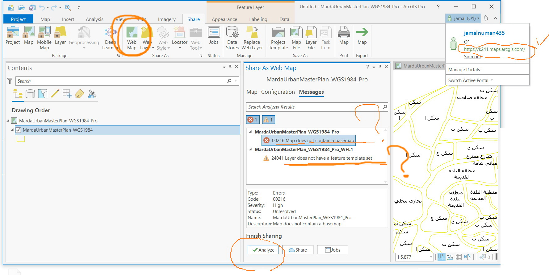

I couldn’t figure out how to resolve the with “basemap” error and “feature template set” warning that come up when publishing with ArcGIS Online option

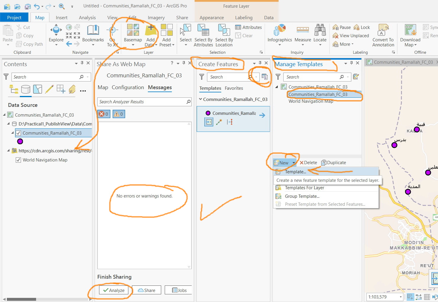

Hi Jamal,
You are encountering the error because you do not have a basemap. A basemap is required when sharing a web map. Inserting a basemap will resolve the error. Please see the following doc: 00216: Map does not contain a basemap—ArcGIS Pro | Documentation.
For the warning, see this: 24041: Layer does not have a feature template set—ArcGIS Pro | Documentation
For future reference, you can open the associated help topic to the errors and warnings by right clicking on the message. A context menu will appear which provides a link to a help topic that describes the problem and lists available solutions.
Analyzer message context menu
Analyze your GIS resource—ArcGIS Pro | Documentation
