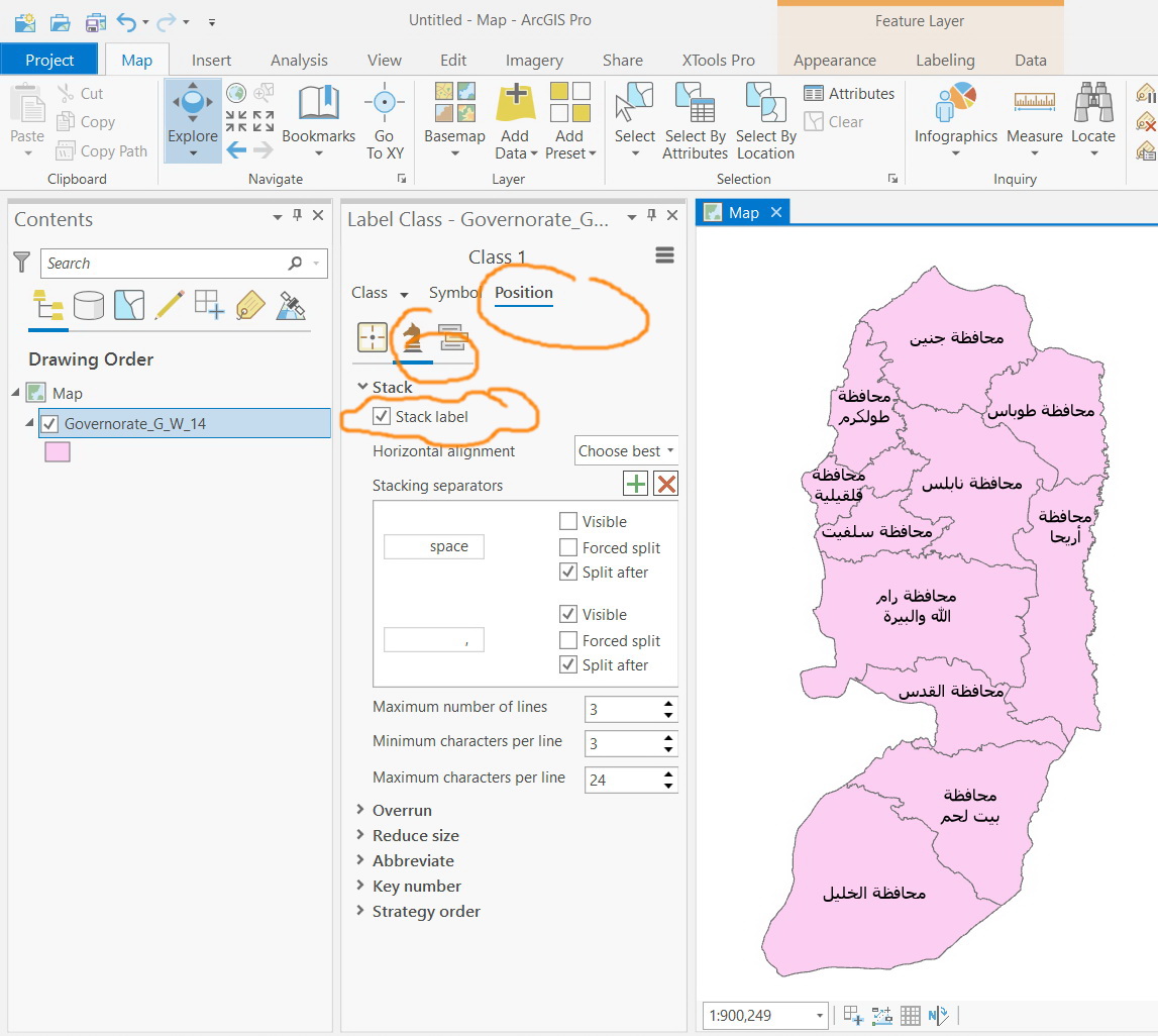

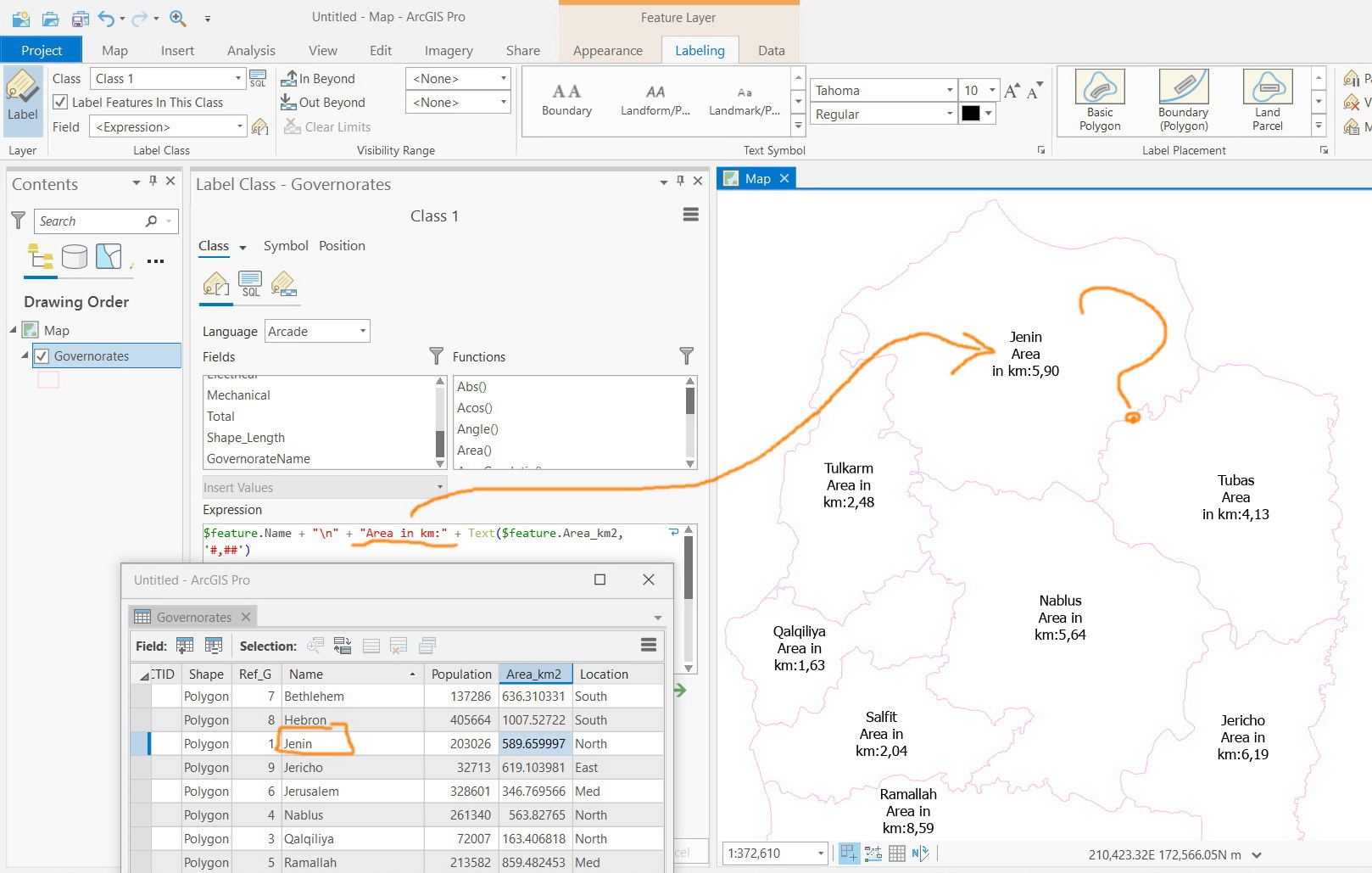

For example, in the screenshot below, I wanted the “Area in km” and its value to appear on the same line.
How this might be performed?

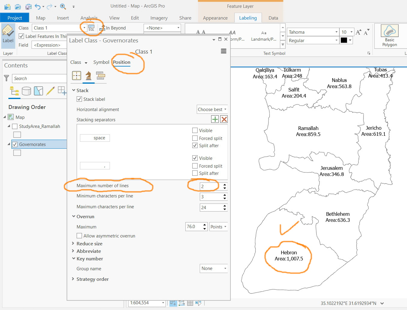

two options
JamalNUMAN
Legendary Contributor
Many thanks Dan for the help. It works fine with me

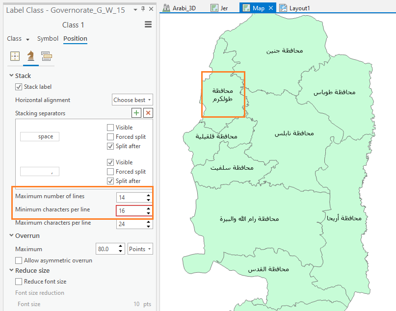

I note that is not working in some scales
What might be the issue here?

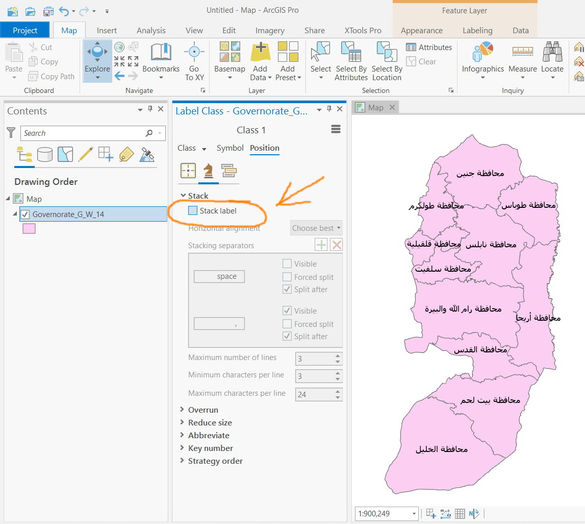

I got that unchecking the “stack label” option should keep all the text on the same line
