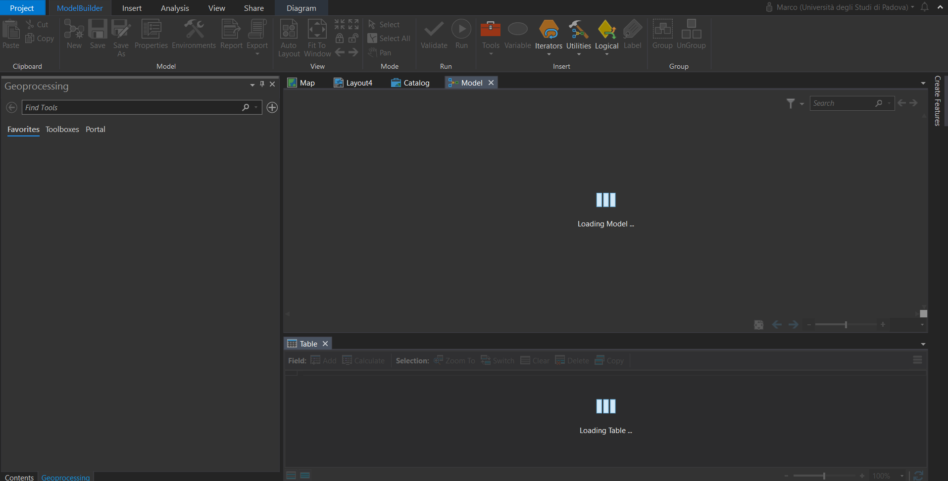

ArcGis is not able to open projects anymore, both saved project or new one. I created a model and while saving it, ArcGis didn't respond. I decided to force stop ArcGis with task manager. Now ArcGis load projects, but is not able to open Map, Layout or geodatabse by Catalog. Below a screen capture of where it is hung.
With new projects it doesn't work in the same way.

Thank you Curtis, I found another comment which describe how to reset application profile in ArcGis Pro. I did it but unfortunately it does resolve my problem.
MarcoSozzi
I solved the problem by clearing cache in Options/Display/Clear cache
