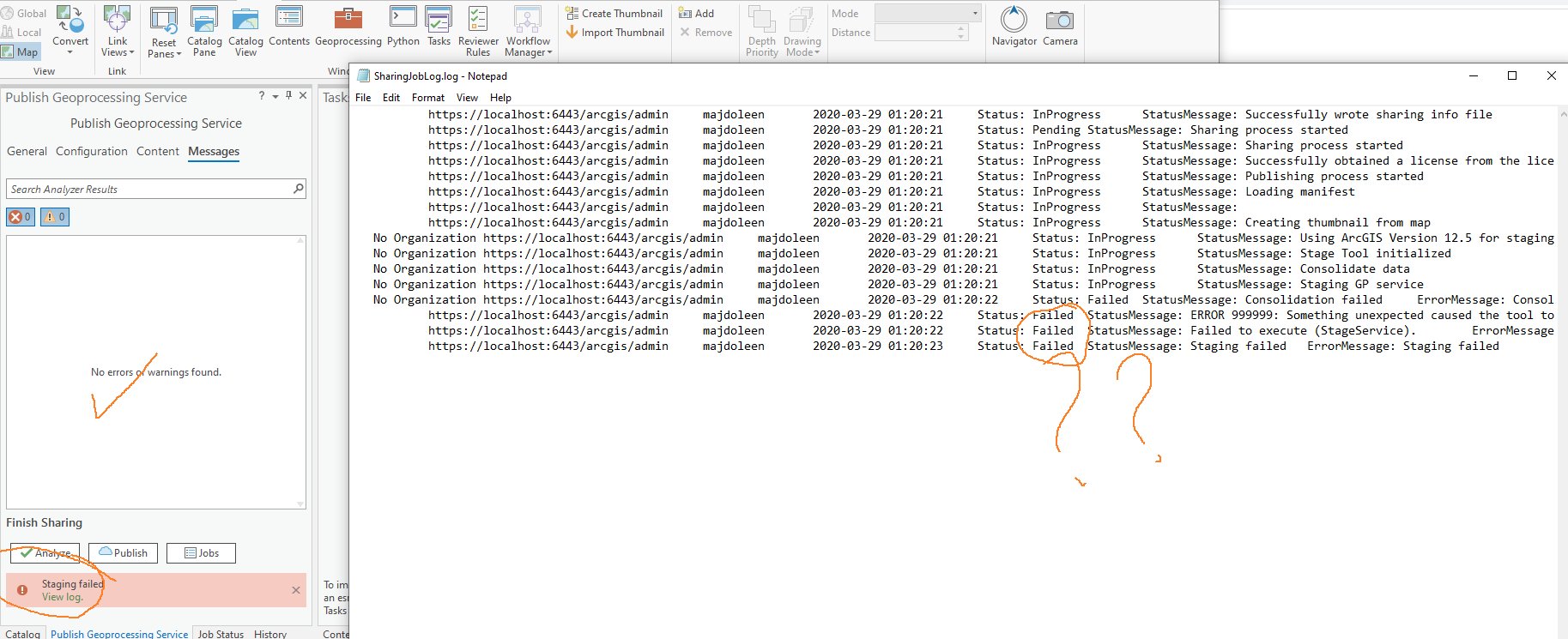

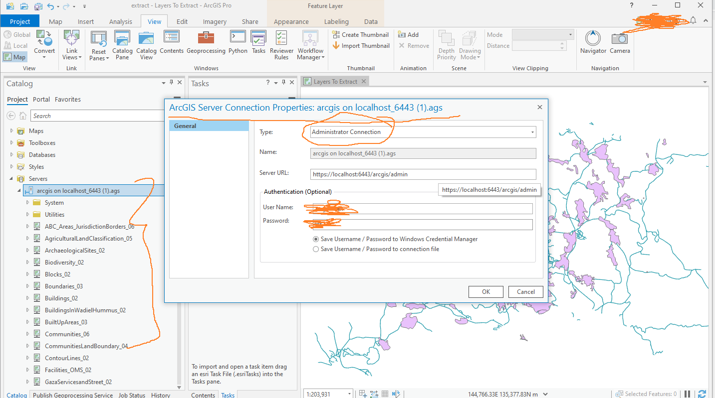

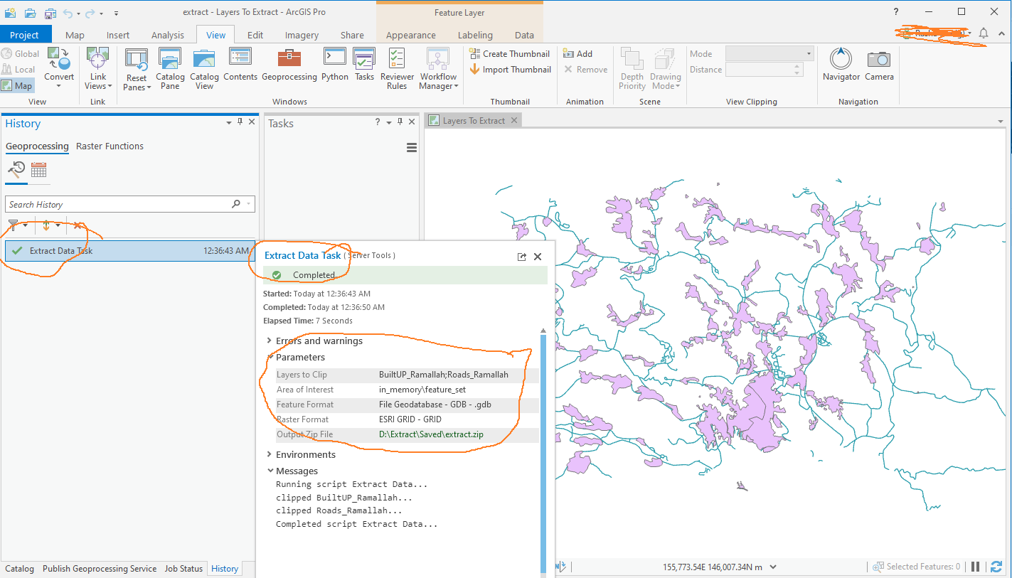

I am trying to publish the extract data task tool using arcgis pro, and I couldn’t figure out why it fails to Publish a Geoprocessing service end with staging failed, I followed the steps below:
  1. 1. I run the extract data task and completed successfully
  2. 2. The Arcgis server connection is set to administration connection.
  3. 3. No errors or warnings are found when analyzed.
Please note that I followed the same steps using arcmap 10.7.1, and all worked fine, what might be the issue here?

Hi again,
I am not sure if I am doing something wrong while running the extract data task, and also I noted that when trying to click on the publish button to publish the tool, it is written that (federated server is not available), taking into considerations that this message only appears when publishing a geoprossing tool,  please have a look in the screen shots below:
