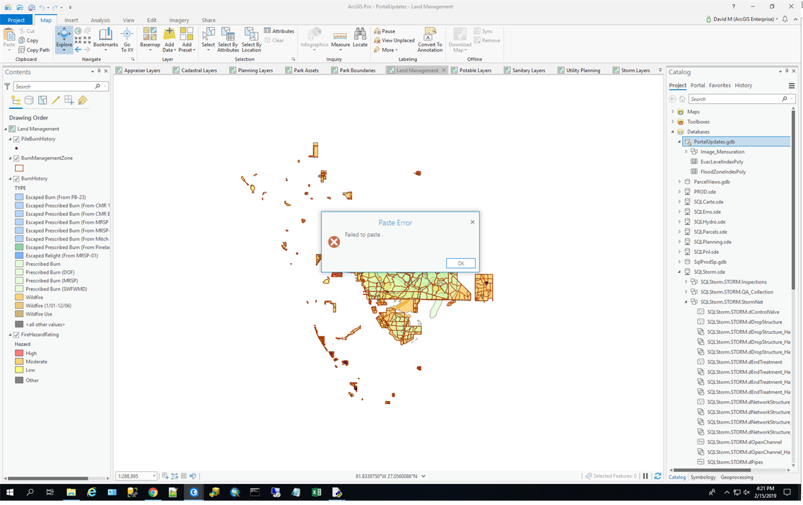

Hello - when trying to perform a simple copy feature class from an SQL Server 2017 SDE layer to my project's file geodatabase, I receive a Copy fail error in ArcGIS Pro 2.3.  This worked in ArcGIS Pro 2.2.x -
This is just a simple layer, no attachments, related tables, topology etc.

The copy/paste workflow. In the catalog pane for Pro, I am selecting the feature, performing a right-click, to activate the context menu>copy, selecting the destination project file gdb, performing a right-click>context menu>paste.

I can confirm that connecting as the data owner does then copy the features to the project file gdb using the copy/paste workflow. I can confirm that the copy gp tool does work when connected using windows authentication.
Jared_Motuz
Thank you for confirming that. I was able to see the same inconsistencies while working in 2.3 and enterprise geodatabases. I would recommend contacting Esri's Tech Support to get the ball rolling on this.
