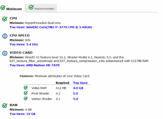

I was running ArcGIS Pro 2.2 with this config:

I did notice some improvment in terms of speed while editing labels, but it is not the very best either. Fairly disappointed even. It looks like there is only 16Gb extra RAM on my new config, but not much more...
Is there any bottleneck in this configuration? Is the Graphic card good enough? What hardware configuration would ESRI  recommend to improve overall performance?
I did use the detection tool provided by ESRI to benchmark my configuration:
It looks like the CPU speed could be faster and the video card better... Any suggestion on this?

The newer generation of core i7 should provide better performance, and the integrated intel graphics should actually (believe it or not) be faster than the Radeon you had before (at least looking at Passmark scores).  The limiting factor with not having dedicated GPU memory is going to be situations where large amounts of data have to be passed between GPU and system memory.  This is more common in 3d than in 2d.
Switching to a dedicated GPU will reduce the framerate/redraw hiccups associated with these transfers, so in general will result in better performance.
If this is a desktop machine, a dedicated GPU would be a worthwhile upgrade for sure.
If it's a laptop and has a Thunderbolt 3 port, you _may_ be able to connect an eGPU (external GPU) to boost performance when it's connected, but be aware that this is a more costly solution since it involves both a GPU and an external enclosure typically.
