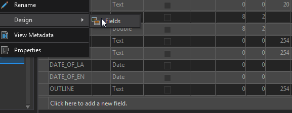

Hi,
Just a simple question. From the Catalog Pane, if I right-click a shapefile -> Design -> Fields, I can view the fields but cannot edit them, such as making a field Nullable for example.
All the fields are greyed out!

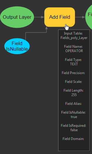

Morever, I made these fields with the ModelBuilder Add Field with a variable set to IsNullable (as the option is not included in the Add Field right-click settings in ModelBuilder)
Finally, if I use Delete Fields (as below), these fields still show up in the Field design pane! As a result, the ModelBuilder crash because it considers these fields still existing...
I am puzzled and I suspect ArcGIS Pro do not refresh features classes after geoprocessing... If I restart, these fields do not show up and I can run the Model...

Following my previous post, it looks like Nullable field are not possible on shapefile, which would explain the greyed out part in the Field Design pane and the IsNullable variable not applied in the ModelBuilder above...

Shapefile fields are not nullable for sure so if at some stage you are using Add Field http://pro.arcgis.com/en/pro-app/tool-reference/data-management/add-field.htm
make sure you set it so that the field is not nullable
