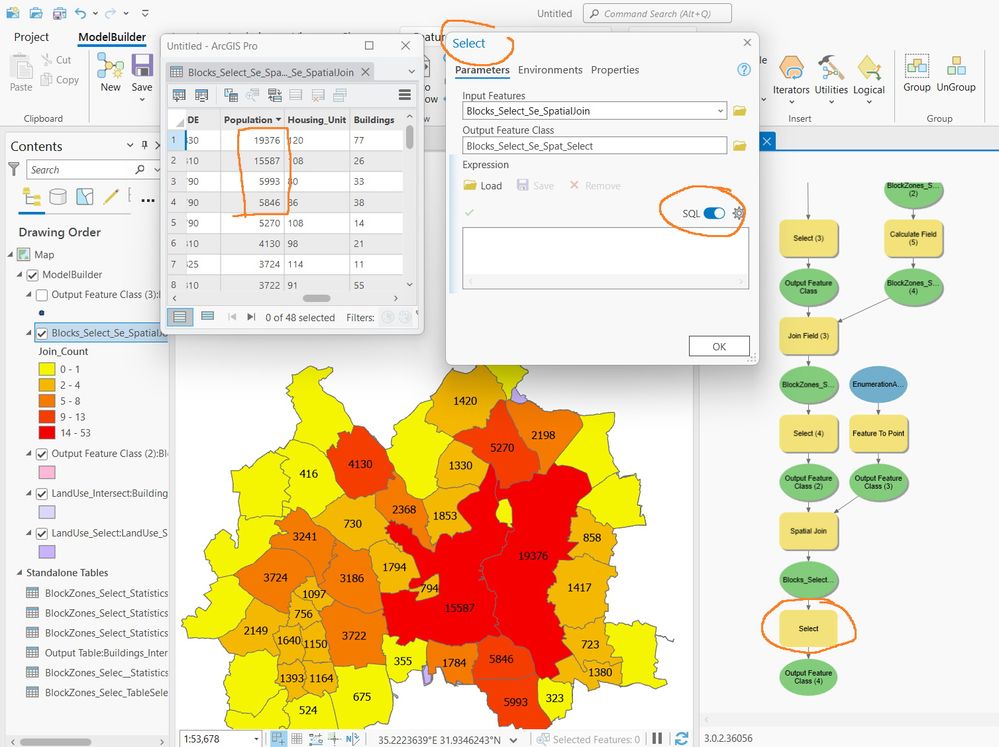

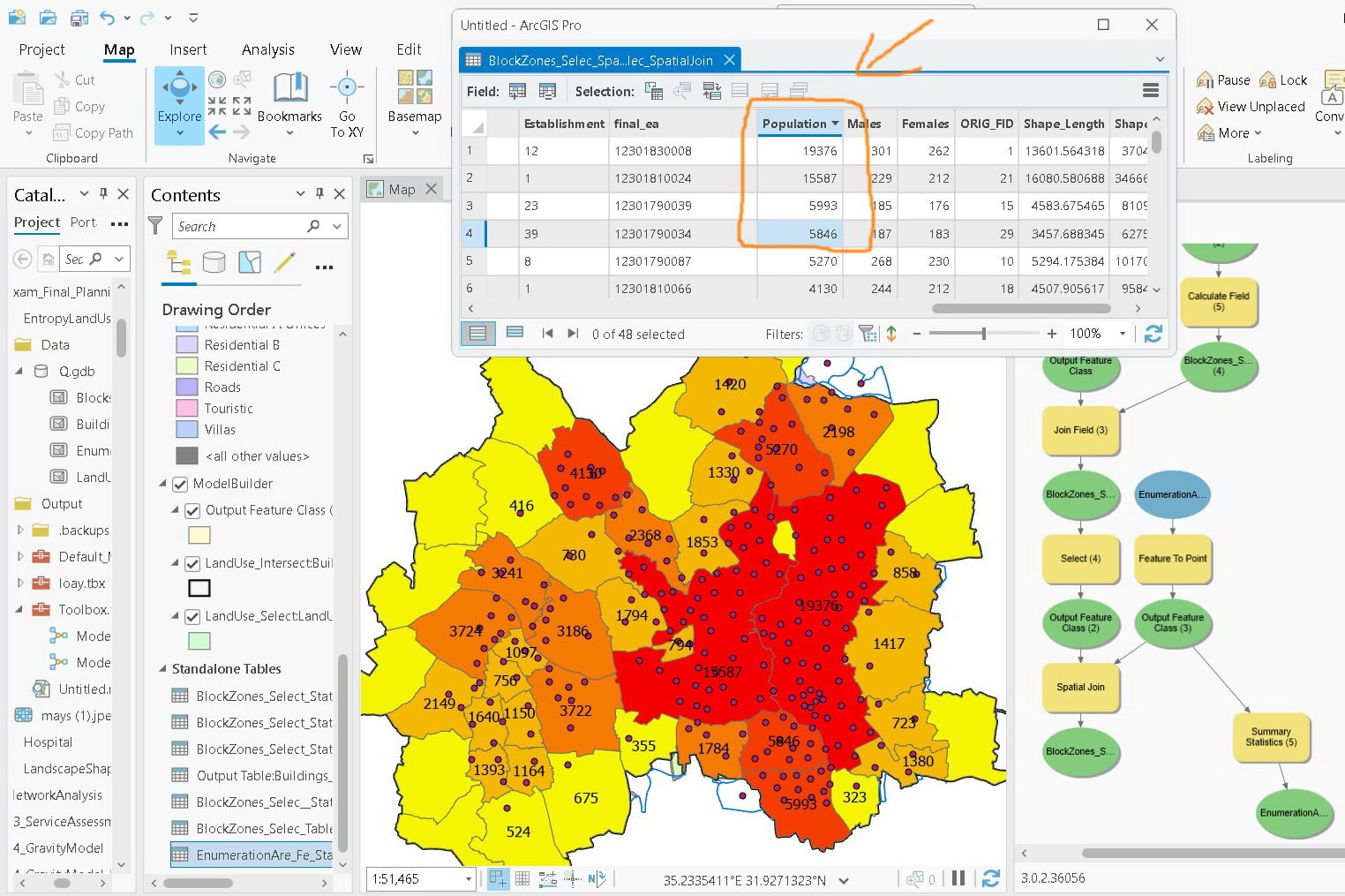

For example, in the screenshot below, I couldn’t figure out which tool can select the FOUR records with the highest population size in the “population” field

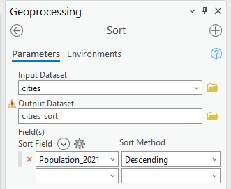

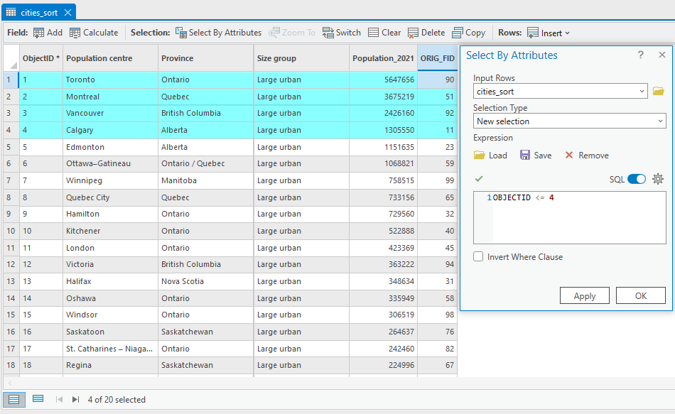

  1. Use the Sort geoprocessing tool to output a FC that is sorted by the population field (desc).
  2. Use Select By Attributes or a definition query to isolate the first 4 ObjectIDs.

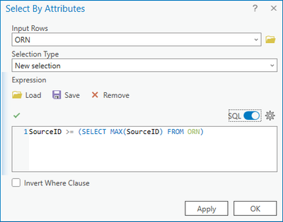

As long as your data is in a file geodatabase (so not a shape file) you can use a subquery to answer this.
An example is shown below, in this example ORN is the layer.

What sql code can select the FOUR records of the highest population size from the “population” field?

My apologies I missed that you wanted the top four values. I'm not sure (but I could be wrong) that a file geodatabase can support the functions that would allow you to answer this question and you need to approach it in a two-step approach in modelbuilder, this how I would have done it.

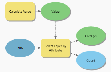

I show this below, in my example I am processing a layer called ORN:

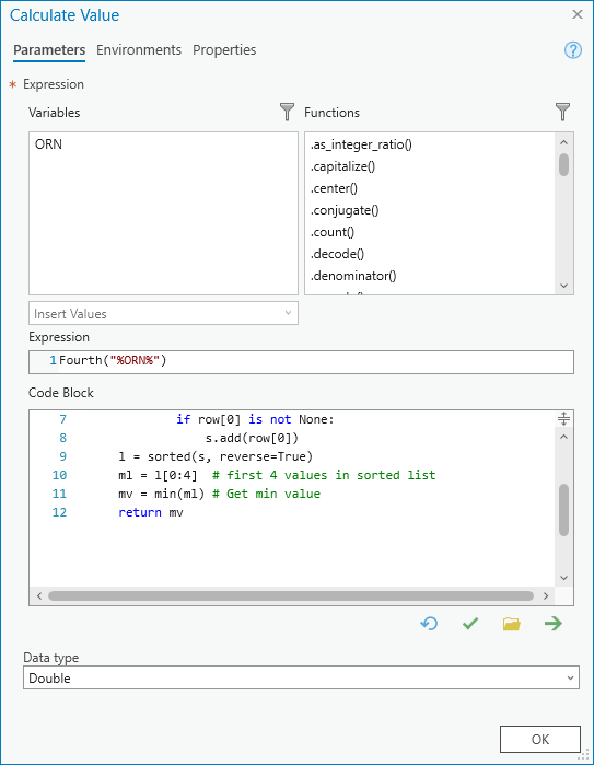

The Calculate Value tool is set up as-is, note it returns double:
The code block is:
def Fourth(layer):
    # You need to set field to the appropriate field
    field = "SourceID"
    s = set()
    with arcpy.da.SearchCursor(layer, field) as cursor:
        for row in cursor:
            if row[0] is not None:
                s.add(row[0])
    l = sorted(s, reverse=True)
    ml = l[0:4]  # first 4 values in sorted list
    mv = min(ml) # Get min value
    return mv
The select by attribute tool is:
This logic will select the top four values in the field sourceID, be aware that the selection may return a selection greater than 4 if you have duplicate values in your field. Also underlying assumption of the code is that you have a minimum of 4 unique values in your field.

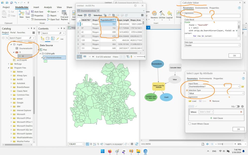

I couldn’t customize the code you have already provide to my local data. In addition to that, the content of the “calculate value” tool in my Pro appears to be different than yours as per the screenshot below.
I’m attaching my data along with the model I tried to build with no success
