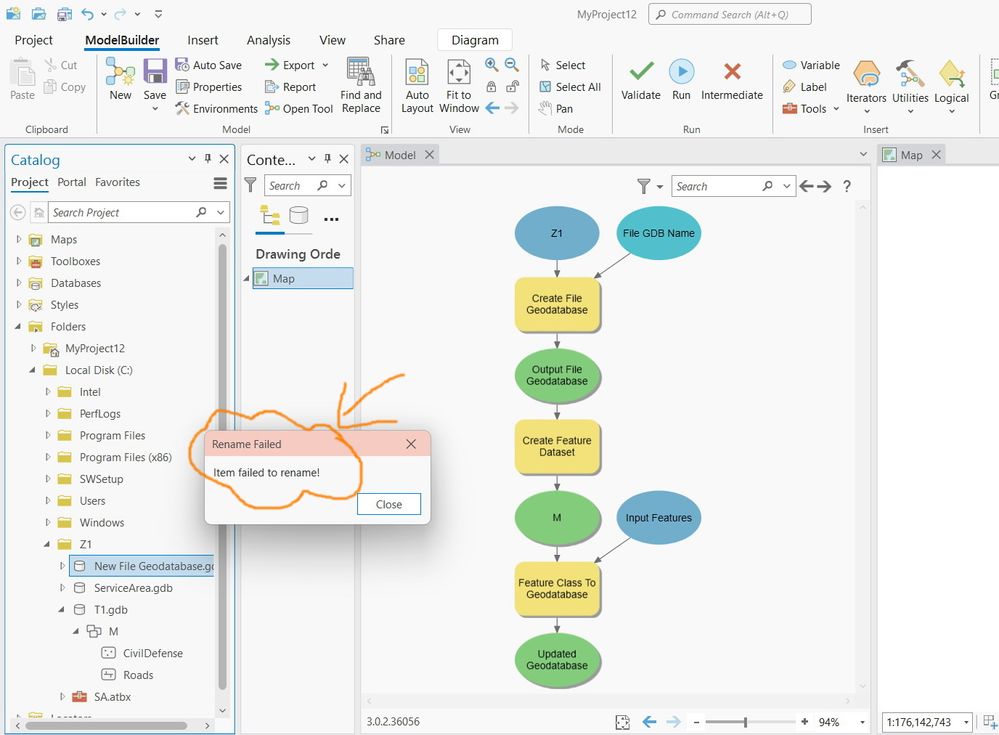

As per the screenshot below, the “create file geodatabase” is the first tool in the model builder. As the model is re-run, the model manages to proceed and doesn’t mention that there is an already created file geodatabase with same name.
What could be the issue here?

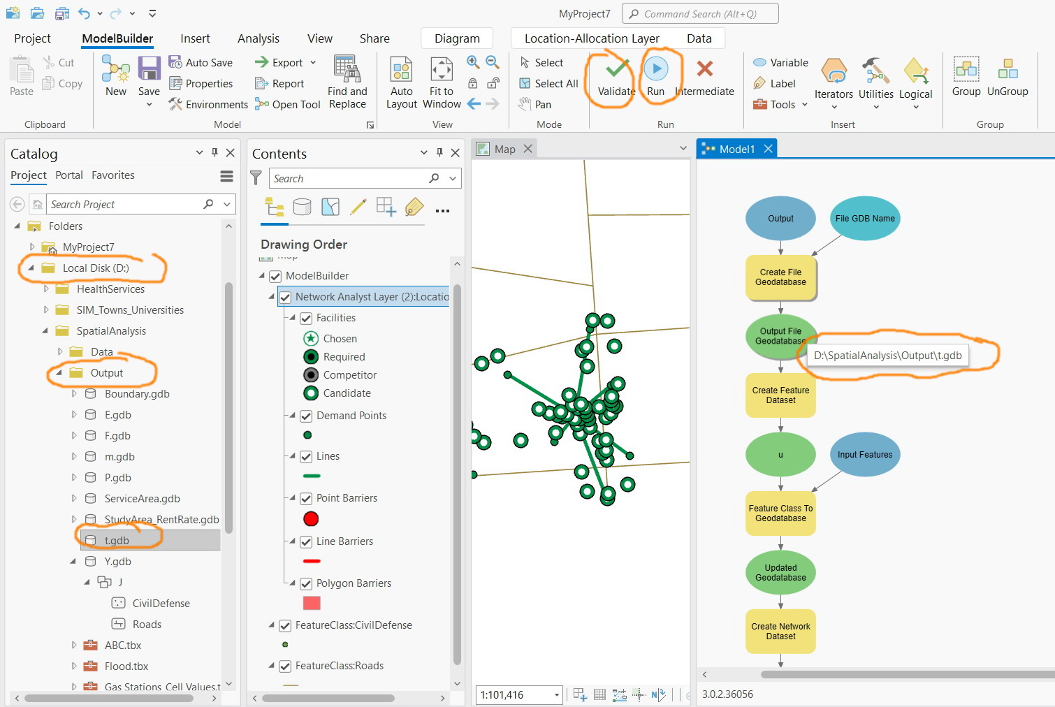

But how come the “create file geodatabase” overwrites the already existing file geodatabase that has the same name if it runs from the model builder while it provides warning if it is performed as stand-alone tool out of the model?
Is this by design? By some settings?
