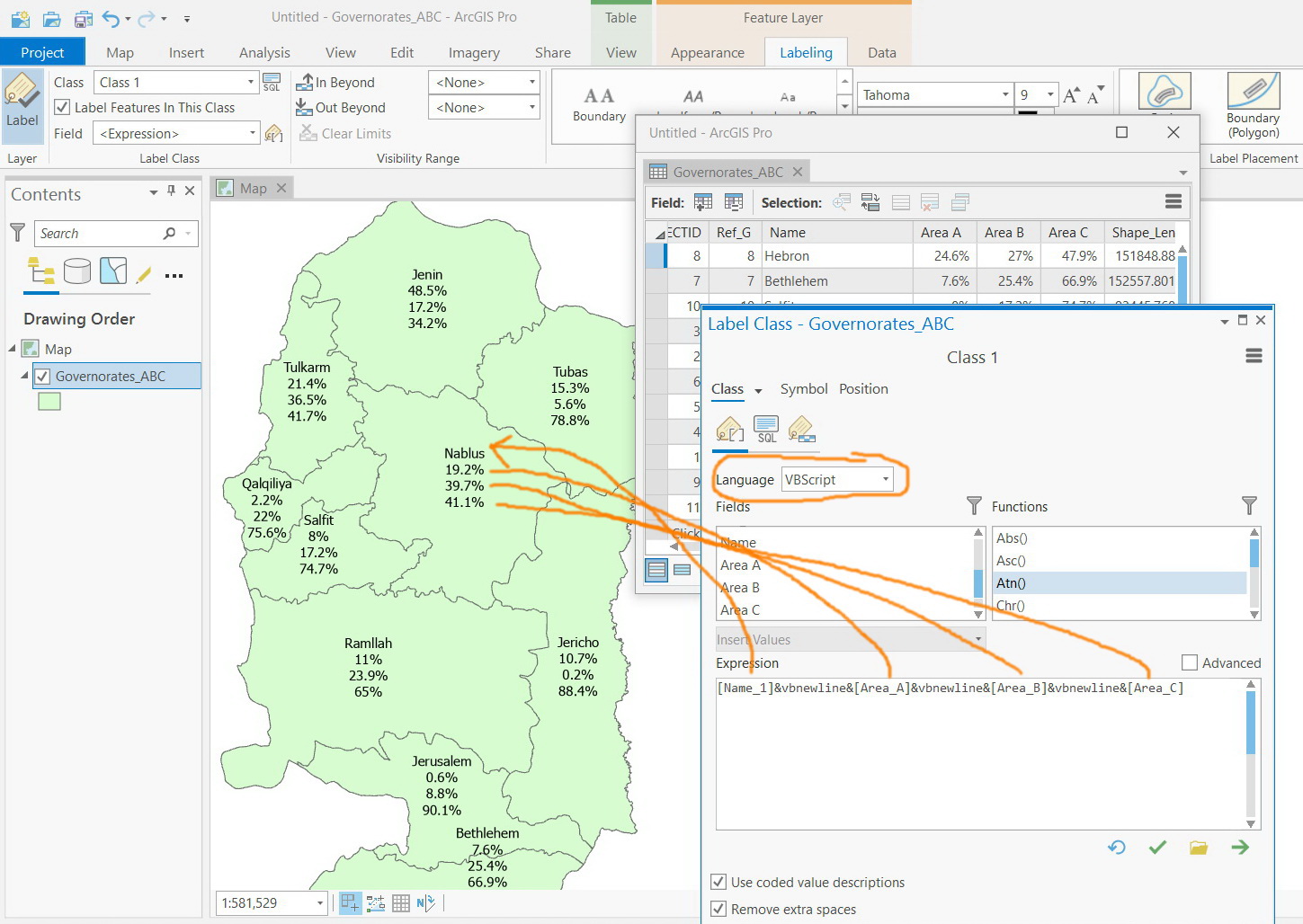

I couldn’t figure out how to set different color for labels using vbscript language shown in the screenshot below. How to set red, blue, green, yallow colors for name, area_A, Area_B, Area_C fields respectively?

Did you see the pages (multiple) on formatting
Text formatting tags—ArcGIS Pro | Documentation
JamalNUMAN
Legendary Contributor
Many thanks Dan.
I managed to get different colors for the labels with the code below
"<BOL><CLR red='255' green='57' blue='42'>" & [Name_1] &  "</CLR></BOL>" &vbnewline& ("<BOL><CLR red='38' green='255' blue='42'>"& [Area_A]&"</CLR></BOL>" ) &vbnewline& ("<BOL><CLR red='21' green='46' blue='255'>"&[Area_B]&"</CLR></BOL>")  &vbnewline& ("<BOL><CLR red='255' green='24' blue='207'>" & [Area_C] &  "</CLR></BOL>")
