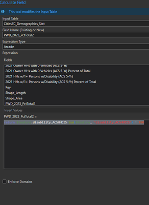

Hi Ken, hope all is well and thank you for the quick response
So based on the original feature class which has multiple columns, the following is what I wrote but I am getting null values.
return $feature.disability_ACSHHDIS/Sum($feature, 'disability_ACSHHDIS') * 100

Ooops, I tested it on a popup, not the field calculator. You have to get the layer from the $datastore variable, not the $layer variable.
var fs = FeatureSetByName($datastore,'your layer name')
return $feature.disability_ACSHHDIS/Sum(fs, 'disability_ACSHHDIS') * 100

Yup that worked like a charm sir cheers 🙂
