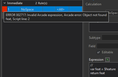

I'm experiencing an issue where lines following a single "//" line are causing Attribute Rules to throw errors when trying to save them. The code below is essentially meaningless, but I can reproduce this exact issue in much larger scripts.
This will not save, and throws the error shown (Object not found feat, Script line: 2).
var feat = $feature
return feat
This, however, saves as expected without any issues:
var feat = $feature
return feat
Seems like in the first example, that commented out first "//" line is ALSO consuming/commenting out the variable assignment on the following Line 2, and therefore the variable object is not found.
I understand there isn't necessarily a good reason to use "//" to comment out a blank line, but I'm curious if this is expected behavior for some reason. Why would adding in an extra blank line make the difference?
