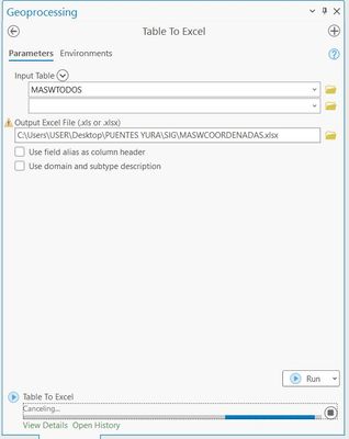

Arc GIS PRO 3.0 table to excel it's crash
1622
07-16-2022 02:35 PM
ArmandoFreites16
Hello, it's simplle the geoprocessing table to excel it's crash. The job finish but the square mesaage not closed. The worse part of this is if the geoprocessing is part of model builder all the process will stop in this point.

To install Pro 3, you need the .NET Desktop Runtime 64 bit.  NOT the .NET Runtime, but the Desktop Runtime 64 bit.
You also need the Microsoft Access Database Engine 2016 Redistributable 64-bit driver to access the Excel files.  However, if you already have the Microsoft Access Database Engine 2016 Redistributable 32-bit driver installed, you will also need the 32-bit .NET Desktop Runtime as well.
So, if you have both Pro and Map installed, you will need to install both 32-bit and 64-bit version of BOTH the .NET Desktop Runtime, and the MS Access DB Engine 2016 Redistrubutable.

ArmandoFreites16
Thank you very much, I solved the problem thanks to this answer
