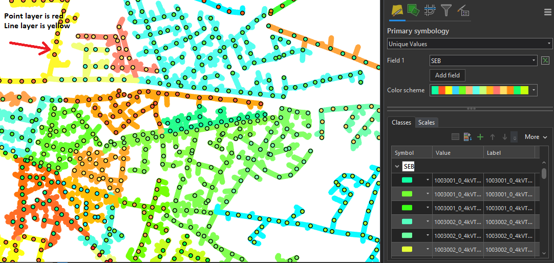

Hello,
In ArcGIS Pro, I have two layers: one Line and one Point. Both have a field named SEB, and this field contains the same values.
For the line layer, I applied Unique Values symbology based on the SEBfield. This created about 40,000 groups, each with a different color.
Now I want to apply the same symbology to the point layer. However, ArcGIS Pro automatically assigns different colors. What I need is: if the value in the SEB field is the same, then the point layer should use the same color as the line layer.
How can I do this in ArcGIS Pro?
Thanks!
Robert_LeClair
Esri Esteemed Contributor
@JohnGoat - so I'm wondering if you can setup attribute driven symbology for the SEB field?  You can learn more about how to do this workflow here:
Attribute-driven symbology—ArcGIS Pro | Documentation
Setting up the attribute-driven color in symbology... - Esri Community
