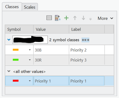

Hamster_On_Coffee
I know I'm late to the party, but this is a lifesaver - thank you so much!
by Anonymous User
Not applicable
Does anyone know if it is possible to move <all other values> in the symbology order? It appears to be stuck at the bottom and I would like it to appear at the top of my legend.
