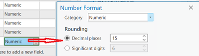

Hi! I am using the convex hull option in the minimum bounding geometry tool in ArcGIS Pro, to obtain the antipodal line and its orientation. While I get the orientation, the length of the line is zero and the coordinates of the antipodal points are the same (see screen capture).  Is it that my features are too small? How could this be solved? I would like to have the points at the ends of the line to recreate that line as another feature. Thanks

I am guessing your data is in decimal degrees. So for a small island, the length value would be too small and perhaps got rounded up to 0 degree. You can open the Field View of the table, find the field and increase the decimal places to 15 (maximum). Save the change. Go back to your table to see if a very small value shows up.
EstebanRodofili
Thanks! That worked! However, when I went to distance and direction to create the antipodal line from the coordinates, a line much longer than it should be appeared. And the type of coordinates selected in the distance and direction tool was decimal degrees. Any idea what could be happening?
