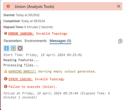

When I perform the Union however, the Union can't complete as I get an Invalid Tolpology error.
I looked into the error code, but the XY resolution and tolerance values are the same for both layers A and B, although different to the base map.
Do you have any advice on getting the union to work?

BobBooth1
I'd suggest running Repair Geometry on each layer first.
https://pro.arcgis.com/en/pro-app/latest/tool-reference/data-management/repair-geometry.htm
You might also create a new file geodatabase and import each of the feature layers into it before running the Union tool.
