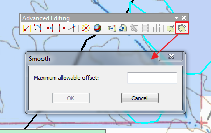

I do realize that you can use the Smooth Line or Smooth Polyline tool in the Geoprocessing toolbox, but it would be very convenient to have a smooth function in the Modify Feature toolset, much like the one in the Advanced Editing toolbar in ArcMap. I've been using ArcGIS Pro 1.1.1 for editing raw GPS data lately, and for the most part, I love it. Cleaning up drainage and road lines from GPS capture with a Bing aerial basemap is much easier in Pro because the aerial layer is actually navigable and fast. I've never had that type of basemap performance in ArcMap. Redraws are painfully slow. In Pro, it's quick and easy, much like a Google Earth-type experience.

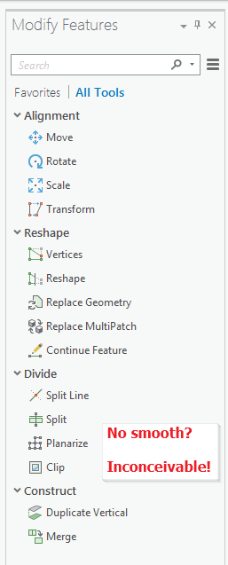

I've got my Quick Access Toolbar all decked out, and editing features is quite streamlined. That is, until I need to smooth the drainage or road or site boundary I just aligned to the aerial. In ArcMap, this is easily accomplished with the Smooth tool on the Advanced Editing Toolbar. The Modify Features toolset is a loose analog to that, but there is a conspicuous absence when it comes to smoothing.  The Geoprocessing tools create a new output every time the tool is run. I don't need that, I simply need to smooth the line or polygon that I've just edited.
ArcMap Advanced Editing Toolbar:
ArcGIS Pro Modify Features Tools:

Hi Travis,
Thanks for your feedback and for editing with ArcGIS Pro.  We started with the basic editing functionality in ArcGIS Pro for both 2D and 3D, adding additional capabilities around templates and some other areas.
Advanced editing functionality is something we've not had the chance to get to yet.  We will be adding shared edge editing and align to shape with the 1.2 release, but i'm afraid smoothing capabilities are still at least one more release away.  I assure it is coming, it is just a matter of fitting it into the schedule.

I found the smooth tool under the generalize editing tool if this helps.  I could not run the smooth geoprocessing tool because of licensing.
Go to Edit > Select Modify (Features) > Select Generalize (located in Reshape Tools) > Choose Smooth Method (there are three available methods) > Select your polygon
Once you select your polygon you will be able to see a preview of how the generalize (smooth) tool will affect the selected polygon.
