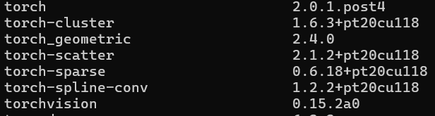

These are the packages in my base environment, which do not work as well:
I would be really glad if anyone knows how to solve this! Thanks
