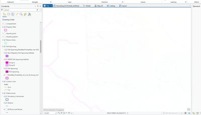

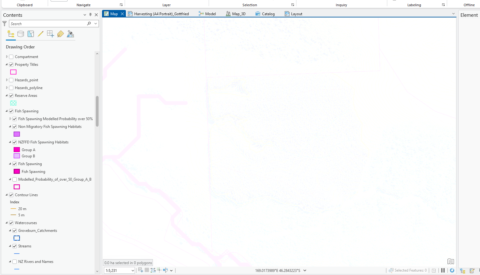

This morning I worked with ArcGIS pro and all my projects where open normally and I was able to work on them. Then I installed the newest update and now I cant see most layers from my projects anymore. Also when i try to create a new projects layers are transparent or doesn't show up at all.
What is going on and how can i fix this?

GottfriedKenda
if i click on zoom to layer it is zooming to the extend but still not showing any raster layers. tried also to create new project just with data from living atlas and it is also not showing anything

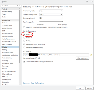

TimCoulombe_DES
I was having the same issue. Changing the Rendering Engine to DirectX12 from DirectX11 in Project-->Options-->Display fixed it.
TammiDoyle
Oooh Tim, you legend. How on earth you found that solution is beyond me, but it appears to have fixed the issue. Thanks for that!
