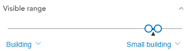

That is a good question. It looks to me that in the grouping of the world imagery, you have to zoom in far enough for the "Citations" layer to become visible, then you can click on the tile to get the info:
But that zoom window of where the Citations is visible is only one small notch around the "small building" size:

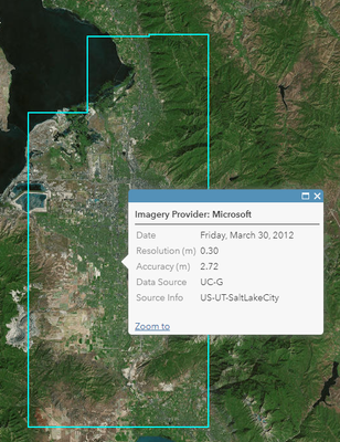

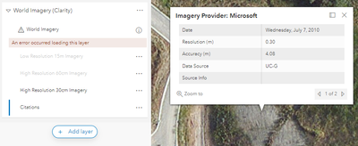

I can't get it in Pro either. The best bet I had was to load in the Citations layer directly through this link:
https://clarity.maptiles.arcgis.com/arcgis/rest/services/World_Imagery/MapServer/4
but that still didn't allow me to see a popup of info...
But if I "zoom to" the feature in ArcGIS Online then I can see the full length of that image:
