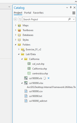

Good morning,
I'm trying to create a very basic map by bringing in an edited .xls file.
I'm attempting to add the file in via folder connection. When I get to the folder and the specific file, I hit refresh on the .xls and I'm unable to drag it into my contents.
This is then followed by a buffering icon and the ArcGIS Pro program "sort of" freezes. I'm able click some buttons but they don't actually work. Perhaps a more appropriate way to describe it is  "soft freeze."
I'm including a screenshot of what I'm seeing, but I don't think that would help much.

StevenDeckard
I went ahead and:
  • Checked my Win Drivers (all good)
  • Tried to add the .xls file via the "Add Data" method (no good)
    • It's stuck refeshing the file, trying to find it when I select it.
  • Official Refresh Excel Tool (no good, it's stuck during the buffering)
    • Same as above.
  • I've even tried a different file format .xlsx
    • No dice.
I'm not sure if you'd be interested in trying it out yourself. It literally shouldn't take more than 2-3 minutes.
I'll be attaching the .xlsx file here. For whatever reason, the Esri Community boards won't let me attach a plain .xls
I have a hunch that it's either:
  • Some unforeseen incompatability issue with v.3.0.1 and excel files
or
  • Something is wrong with my PC and how I installed Pro.
