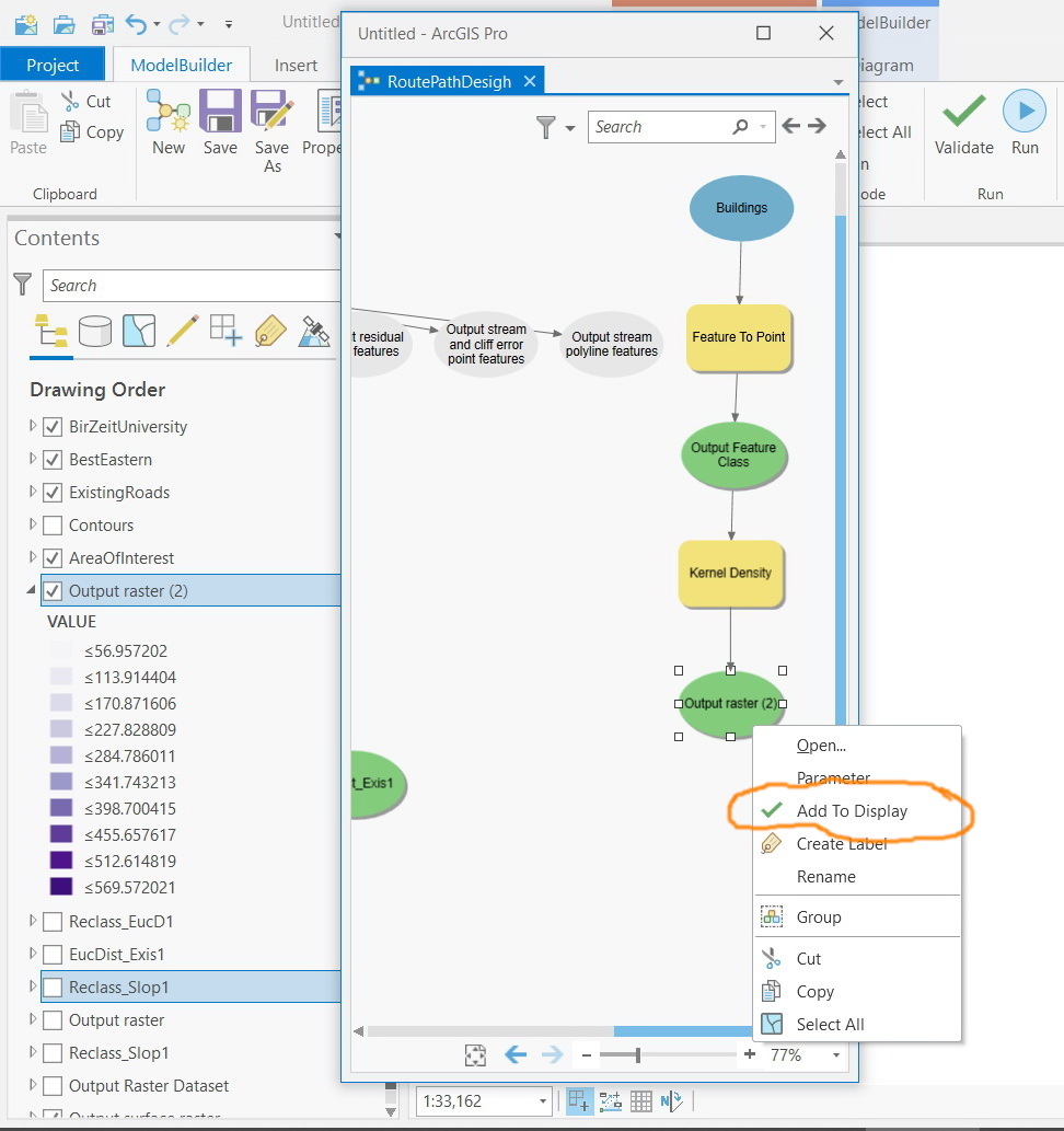

I couldn’t figure out how to set select the “add to display” option for models created in ArcGIS Pro,

they have to be model parameters to be added to the display

it works fine. In ArcGIS Desktop, the (P) indicates for a totally different feature!

P  ==>  It is either an input parameter (which you get to specify when the model is run) or an output parameter (something that is created and you get to specify its name for instance).  If there is no P... then it will be hardcoded in the model and not added as a result to the display

Is there any option that can be set in order to get “add to display” selected by default so that the out is added automatically to the table of content?

In 2.5, there is no need to let the output as “parameter” in order to get the “add to display” option available

When one is enjoying the benefits of having one's model output added to the display through the empowering of this nifty verdant check mark, is it possible to enjoin ARCPRO to reproduce said data into the Table of Contents under its actual name instead of the name of the Blue Bubble in which it resides in the Model space?
