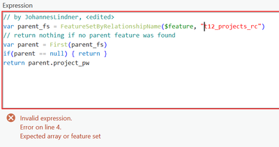

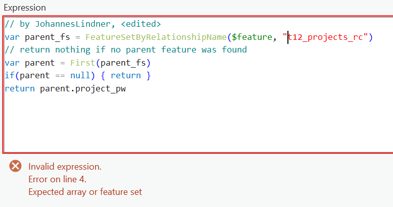

I am adapting an arcade expression attribute rule by @JohannesLindner (https://community.esri.com/t5/arcgis-pro-questions/attribute-rule-to-pass-a-value-from-parent-to/m-p...) where I have a relationship class.  Arcade isn't a particular strength and could use an assist debugging.  Here is this script and the error.
I need to pass a field value (project_pw) from parent to child when children are created.
Any tips would be greatly appreciated.
Tyler

// by JohannesLindner, <edited>
var parent_fs = FeatureSetByRelationshipName($feature, "t12_projects_rc")
// return nothing if no parent feature was found
var parent = First(parent_fs)
if(parent == null) { return }
return parent.project_pw
<error>
Invalid expression.
Error on line 4.
Expected array or feature set

Have you tried removing the First function? I'm wondering if the FeatureSetByRelationshipName is already grabbing only the one parent feature, and thus first would be throwing an error because it's looking for an array (ie multiple things)?
Happy mapping,
- Zach
TylerT
@ZachBodenner; That cleared the invalid expression.  I now have a valid expression.  Thank you.  Maybe the First() is for a many to many?

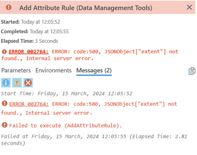

New problem.  The tool runs but fails with this error.
Any ideas about this error?
<snip>
ERROR 002764: ERROR: code:500, JSONObject["extent"] not found., Internal server error.
Failed to execute (AddAttributeRule).
Failed at Friday, 15 March, 2024 12:05:55 (Elapsed Time: 2.81 seconds)

The Parent is a hosted Feature Service Feature Class (polygon) on ArcGIS Enterprise Portal.  The Child is a hosted Feature Service Table.  They are related by a 1:M feature class.
The field I want to pass from Parent to Child is a text field (basically project number).  Some Parent fields are null.  The desire triggers are insert and update.
ZachBodenner
MVP Regular Contributor
Ah, that might be the issue. Based on previous entries on the community, Hosted services cannot have attribute rules applied:
https://community.esri.com/t5/attribute-rules-questions/can-attribute-rules-be-used-on-feature-servi....
Though I would also suggest marking the removal of the First function as a solution since it solved the Arcade error you were getting.
Happy mapping,
- Zach
TylerT
@ZachBodenner , It seems you are correct that attribute rules are not supported in hosted feature classes.  Interesting.  Thank you.
