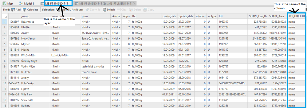

DavidMrázek
I thought of it this way: A layer has an attribute table that contains a column, I would like to add to that column the name of the layer that is the table.
Shown in the picture
Instead of name, I would like the name of the layer.

DavidMrázek
So I'm making a mistake there, that's why I still can't, my attempt to write doesn't work: "\" "+ name +" \ ""
"name" is a changing value in foreach
