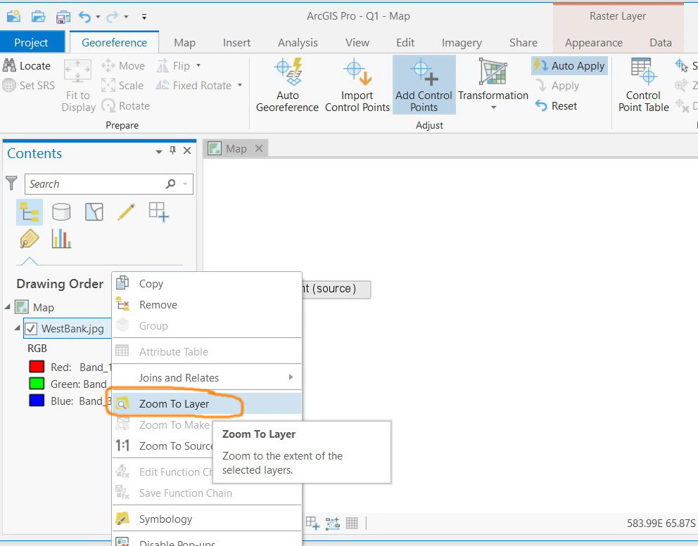

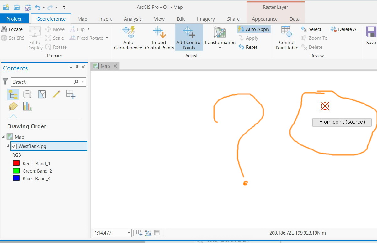

In the screenshots below, the image is georeferenced with one control point. However, as the “zoom to layer” tool is applied, the image fails to appear.
What might be the issue here?

What is the coordinate system of the image?
This issue may arise if the image is of a low quality (check the number of Rows/Columns).
Alternatively, you could Turn Off Auto Apply tool in the Adjust Group, so that the image doesn't move while adding the GCPs.

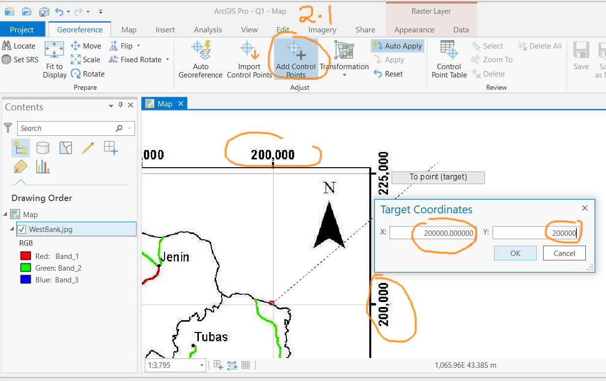

The same image is georeferenced in ArcMap without any issue.
The coordinate system of the data frame (Map) is “Palestine 1923 Palestine Grid”. The image is attached

You should always provide multiple points. With 1 point a zero-order polynomial shift is applied. Keep in minder that the jpg has no cell size and the result will not be in any way precise. It will use the cellsize of 1 unit and not apply transformation towards the appropriate cell size. You will need at least 3 control points to aplpy a first-order or affine transformation to shift, scale, and rotate a raster dataset. This will keep straight lines straight. Choose the 3 control points well spread of the image to get a decent result.
