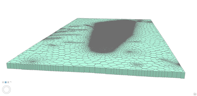

I have imported my model into ArcGIS Pro in the form of extruded polygons that look like this and contain an attribute column for its top elevation, and another column for its base elevation (in m AHD):

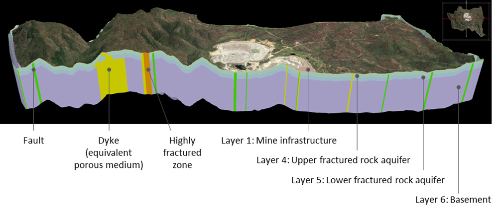

  • How to drape a world imagery to the top of the model? (see example below)
  • How to create a sectional view? (see example below)

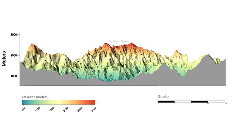

  • How to create a scale for the z axis? (see example below)

Hey @KrisianZurawski I do a bit of a bit of a hack on my cross sections for the scale. I create a 3d line feature to use for the scale for display. I create that line in a 2d map. I then apply a vertical elevation that I want for the to and bottom. I create vertical bounds for the start and end editing in the 3d view from those endpoints. I then use the "create points along a line" geoprocessing tool to create the scale tic labels. For the vertical scale I do the same thing. I use the 3d symbols to make it look nice. This is a screen shot of what that looks like.
