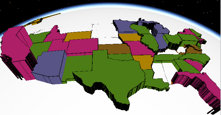

Using ArcGIS Pro 1.2 to publish a web scene with extruded state polygons.  In ArcGIS Pro, they appear correctly and it passes the analysis.  Here is how it appears in ArcGIS Pro:

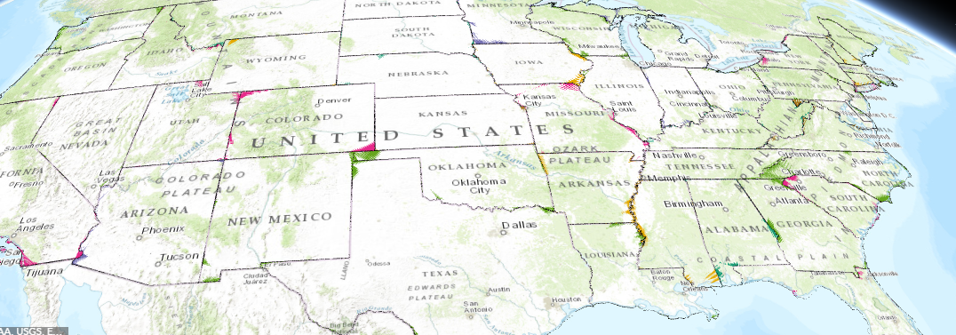

When I load the map in ArcGIS Online the extrusions do not appear to work:
The color symbology is correct but it is rendering them as if this were a 2D surface with y-axis vertices at the state boundaries.
Suggestions?

I replied to this same query on stackexchange.
Here's the answer:  Publishing 3D scene from ArcGIS Pro 1.2 - Extruded Polygons are not working - Geographic Information...
SUM: Extruded features aren't supported in web scene publishing at the current release of Pro and ArcGIS Online (or to Portal whether on premises or in the cloud).
