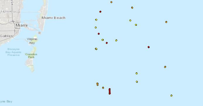

Here is the results layer - supposedly co-travelers:

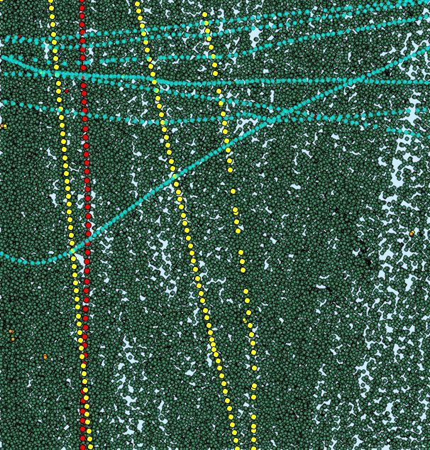

This is the real picture:

Follow up question, in the image that you have attached above, we have two distinct sets of tracks that could be identified as cotraveling.  The one on the left (red/yellow) sort of crosses each other, while the one on the right (yellow/yellow) appears to be diverging.  Would you think that it is useful to include the how those bearings are related to one another?  Because if something is converging/diverging may be of relevance as well.

I suppose I would think of it differently.  Any time two tracks meet the input criteria (space distance, time distance, and the new "mininum time for converged tracks" parameter *), it's the converged tracks alone that interest us.  Because every set of cotraveling (converged) tracks will have a segment before when they are converging, and a segment afterward when they are diverging.  Both converging and diverging will always be present before and after the valid "cotraveling (converged) segment.  It seems to me that they don't need to be characterized.
Another way to put this might be:  In the condition where the tracks meet the desired criteria, they are neither converging or diverging.
