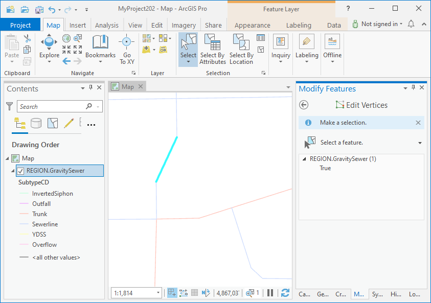

I have read-only access to a feature class in an enterprise geodatabase. I've selected a feature, and I want to see a list of its vertices (including the X, Y, Z, & M coordinates).
If the FC were editable, I'd be able to do that using the Modify Features —> Edit Vertices pane. But that doesn't seem to work for non-editable FCs.
The Edit Vertices button isn't available. Bud_2-1700859072395.pngBud_2-1700859072395.png
Could that be changed so that we can view a read-only FC's vertices/coordiantes?

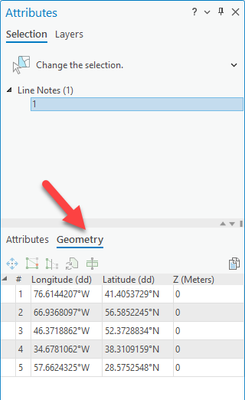

@Bud To see the geometry of a read-only layer you can use the Geometry tab found within the Attributes Pane:
ref: https://pro.arcgis.com/en/pro-app/latest/help/editing/edit-feature-attributes.htm#ESRI_SECTION1_E279...
