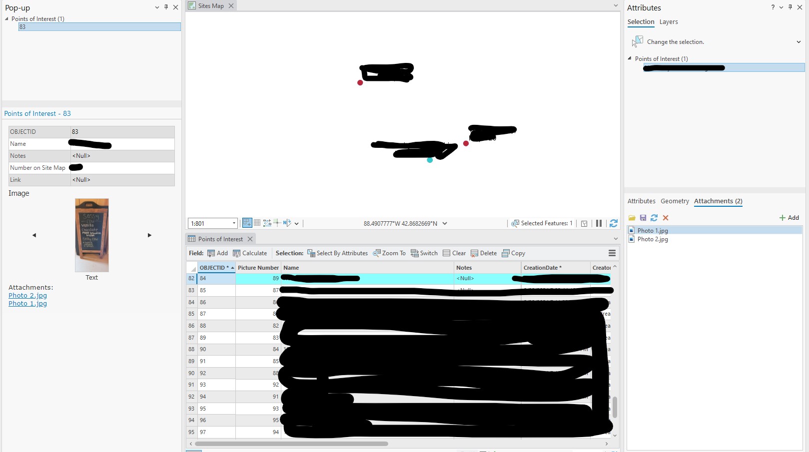

Hello,
I have photos as attachments in my AGOL hosted point feature class. I have that feature service added into ArcGIS Pro. I am editing the photos and I need a faster way to view the photos as I zoom to each point. Currently, I am double clicking on the point in the attribute table to zoom to the point, then using the Explore tool to open the Pop-up on that point so I can view the photo in the pop-up. I have configured the pop-up to show the photo.
Can you please add the ability to see the photo/image attachment in the Attributes Pane? Now all we can see is Photo 1.jpg and Photo 2.jpg. And we have to open each attachment to view it.
Thank you,
A
4 Comments
JenniferCadkin
In the Attribute pane, hover over the Attachment name to show the screentip.  A preview of the attachment will show in the screentip.  Does this help any?
AndreaB_
Yeah, that helps. I never knew that, ha!! Thanks.
I still think it would be nice to have the picture shown there without hovering.
JenniferCadkin
I figured it could help some but would not address your enhancement request.  Thank you for the follow-up.

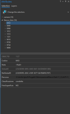

SMauri
@JenniferCadkin
This suggestion doesn't help in my case. The photos accessible as links in the table are not attachments to the table itself, and with my "Standard" ArcGIS Pro license, I cannot enable the Attachments functionality.
Cheers
Stefano
