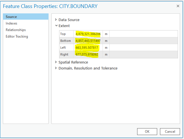

Copy the values of the extents from the FC properties:

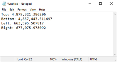

I manually typed the words "Top:", "Bottom:", "Left:", and "Right:" in order to keep track of the coordinates, since the order in the properties window is inconsistent with GP tools.

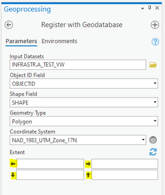

Copy the text from Notepad into the Register with Geodatabase geoprocessing tool parameters:
