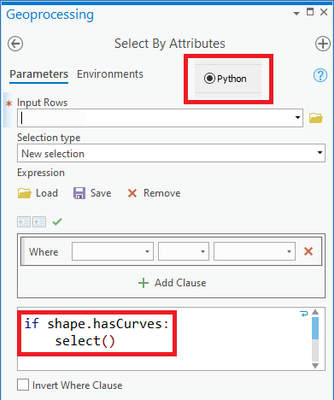

We have scenarios where we want to select rows in a FC in the attribute table, but there isn't a way to run the query using the Select by Attributes window — due to limitations in SQL / SDE.ST_GEOEMTRY functions.
For example: Select features that have true curves. While it's not possible to make that selection via SQL, it's relatively easy to find the records via ArcPy using the hasCurves Geometry property.
Could ESRI consider giving us a way to Select by Attributes using Python — via functionality right in the Attribute Table window?
Something kind of like this?

Bud
@RandyCasey Thanks for the details.
In hindsight, my original post wasn't clear. I've updated it.
I'm thinking it might be handy if we could make Python selections right in the Select by Attributes window...using really short snippets of Python code, instead of full Python scripts. Kind of like what we do in the field calculator in ArcMap: have the option of using VB Script or Python. But instead, in the Select by Attributes window, have the option of using a SQL WHERE clause or a Python snippet.

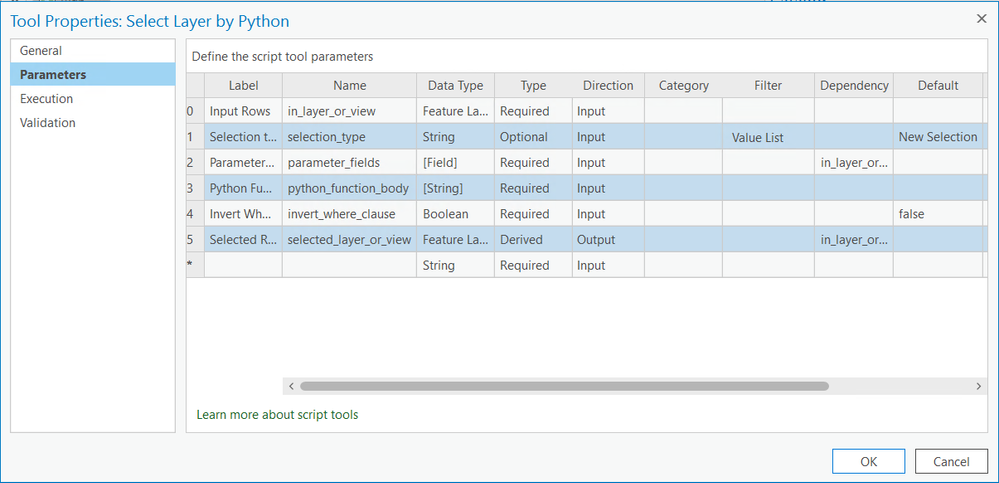

Felt like solving a challenge so here's a working tool. I can't attach the full tool so here's the components:
Parameters:
Execution:

The Python Function Body parameter is a bit of a hack, it uses multiple string params in lieu of a proper text box (ESRI pls). I also didn't implement parameter parsing like the Calculate Field tool does so your function parameters are just the field names in lower case (e.g. the field "ParcelID" is accessed as "parcelid"). It'll also convert the shape field to python geometry objects just like the "SHAPE@" cursor token so you can do shape.firstPoint.X and such. There's probably some bugs lurking in here and using eval to run arbitrary input can cause issues but overall this'll get you what you need.
DavidSolari
Also, forgot to mention this, but the way you use the tool is to write a Python function that takes in 1 or more fields for each record and returns a boolean value to determine if it's selected or not. For example, if you have a text field called "CustomerName" and you want to select every record whose customer has a first name over 10 characters, your python function would be "return len(customername.split()[0] if customername else 0) > 10".
